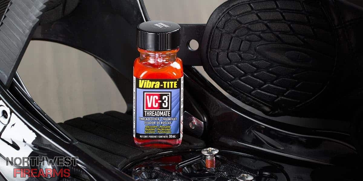

If you're not familiar with Vibra-tite VC3, now you are. :)
It's great stuff! It's a thread locker that is designed for screws that need to be periodically adjusted or removed. Think you can remove them up to five times before the screw needs to be retreated, if memory serves.
I use it on all my holster retention adjustment screws among other things.

Second, if you do use loctite, don't use blue or red. Purple 222 would be best as it isn't quite as difficult to remove.
