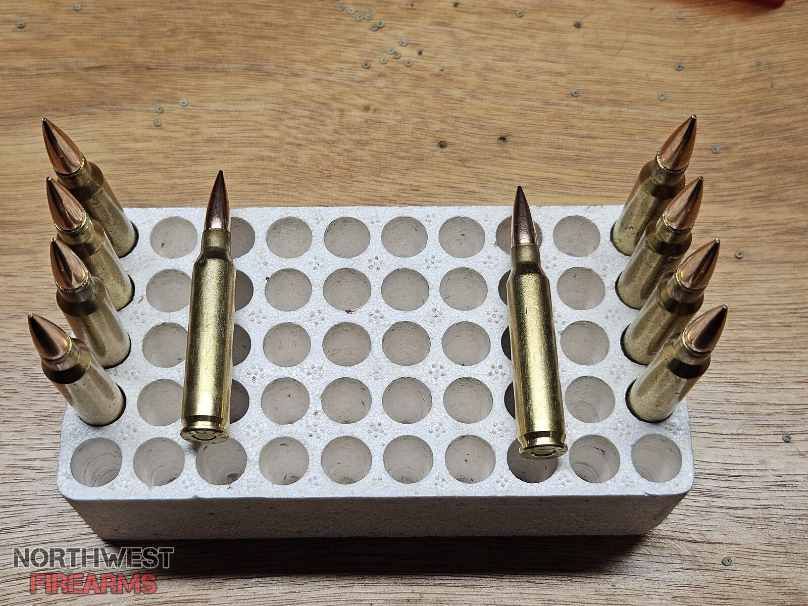

I loaded up 5 with 6 grains of TB and 5 with 6.5 grains of TB. I seated them to about 2.35 OAL. They could probably be seated a little deeper but....
I might have went a little heavy on crimp but since this is a smooth bullet I wanted to make sure the bullet didn't go anywhere until it's fired.

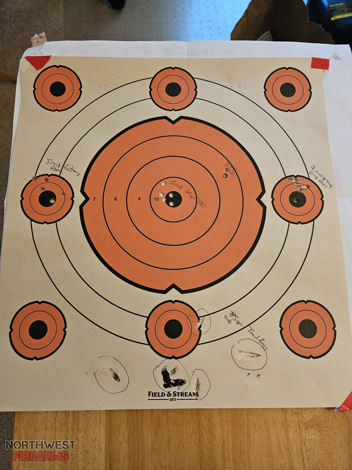

This load was a dismal failure. I believe they were subsonic and that was backed up by a couple of shooters next to my bench that I ask to listen to the report. The problem was they were super unstable. The few that actually hit the target went through sideways.
Look at the bottom center of this target near the brand logo for the evidence. This was 50yd shooting.
If these could pentetrate a target and continue tumbling inside the target. They might work but the target better be really close if you want to be able to hit it. I may try this load again in a 1/7 twist barrel and at very close range. That test will have to wait for a cabin trip. If they stabilize enough to hit a 2l bottle at 15ft, I will test that as well.
