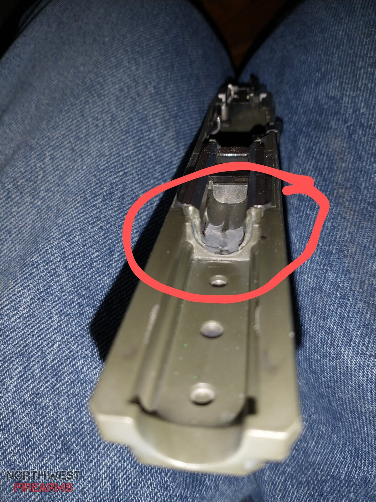

I can't respond on 45 Colt, but I do know that their 10mm beat the poop outa my frame even with a 24 pound spring. I have read a lot of stories about their consistency both up and down.
