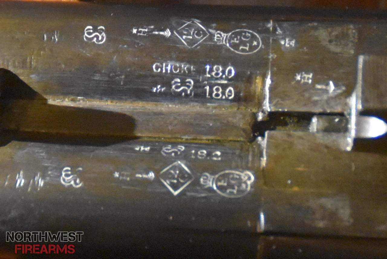

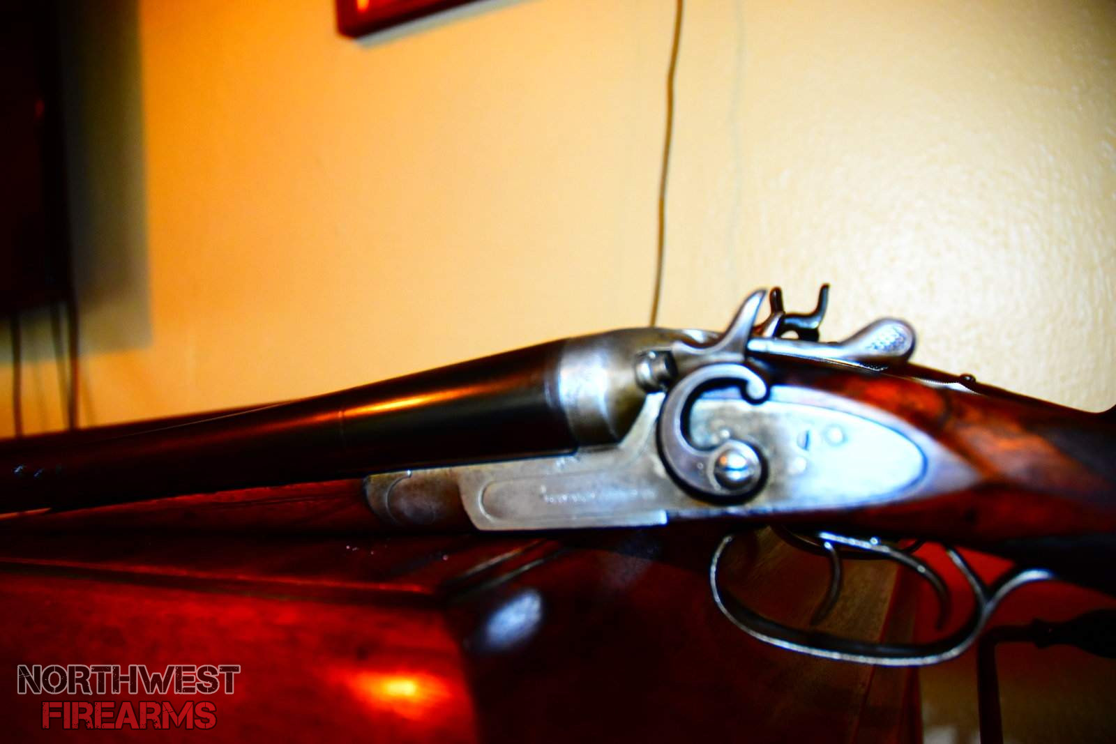

I was looking for more info anyone might have in this gun. It's a Belgian Bayard arms 12ga hammer gun, not as old as it seems. Seems to be a mid range gun. From the proofs it seems to be only black powder proofed and probably late teens early 20s. The marks contradict each other a bit based on the charts I've seen. It says "damascus finish" but im not sure if that means It's damascus or if it was finished to imitate damascus, I tried some acids on it and couldn't get any faint pattern to show. Id like to shoot light smokeless loads in it for convenience, but obviously not if it's a black powder only gun. If anyone can provide any more info in the proof or bayard...

All the marks that I can see and have reference to ...are indeed blackpowder proofs.
Do you know the chamber length...?

if it was mine , I'd check the chambers for length...make sure the rest of the gun were sound , order shells from RST and have dandy grouse gun.
As for Damascus finish ...that means a steel or iron barrel with a fake Damascus pattern put on the barrel...usually this is etched on.

Guns of this era usually had 2 1/2" chambers. As Andy notes, all the proofs are for a black powder arm - do NOT use ANY form of smokeless propellant in this gun - it is indeed only proofed by BP.

In my opinion...from my experience shooting these and other old blackpowder proof guns...
A light field load , target / skeet load* will be okay...if the rest of the gun is sound and you have steel barrels.

Smokeless loads ...loaded to black powder pressures...Kinda like how some .45-70 loads are loaded with smokeless powder but are safe for the antique "Trapdoor" Springfield series of rifles and carbines....or the RST loads that I mentioned earlier...
I might try some ultra low pressure BP loads(under 6000) like the rst loads, but I'll give it a few rounds in rounds of bp first and see how it shoots. It's not an actual damascus Barrell as far as I can tell and made in the 1910s-20s
