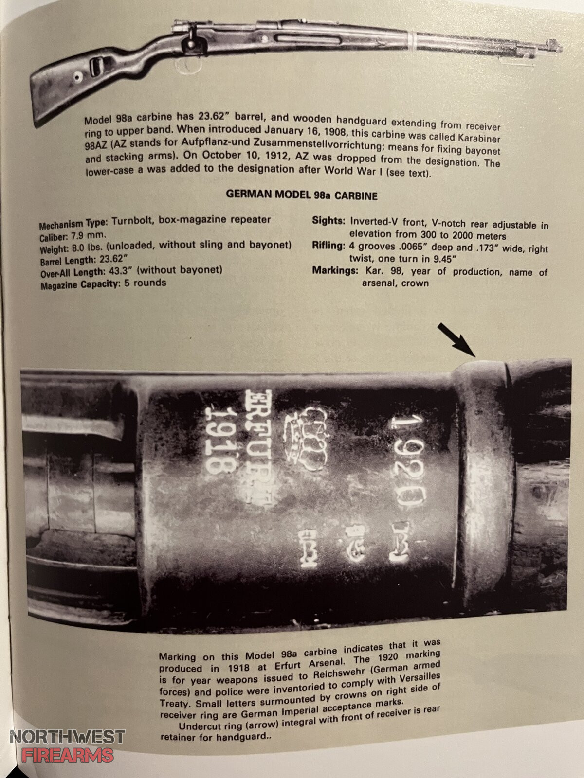

I don't know about all that. Sorry to be late to the party. Took me a while to find my reference guides. I guess I will just parrot what others have said. WWI production Kar98.
This is what my books said. I recommend both these texts if Mausers interest you, as well as the Kuhnhausen manual…
My assumption is that like most German guns, it had quite the travels after its initial German service. I cannot find my markings manual at the moment (still unpacking two years later), so the proof marks I won't be helpful with.
