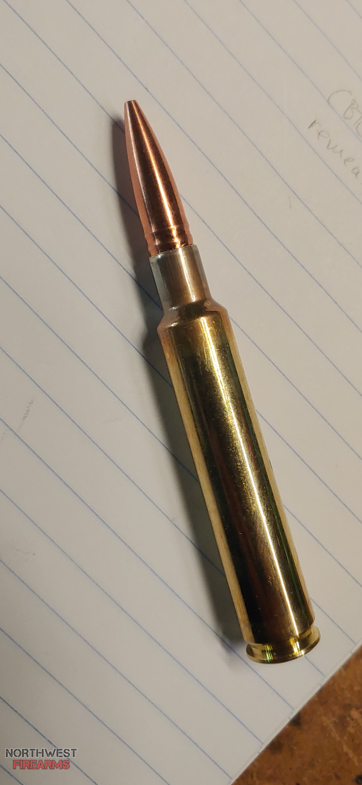

Heres my pressure ladder with Peterson brass, and an interesting observation regarding the 3% case volume difference.
Peterson, COAL 3.345", H4350: charge/velocity
54/2916
55/3047
55.5/3038
56/3102
56.3/3122
56.6/3133
56.9/3147
57.2/3162
57.5/3192
57.8/3204
58.1/3212
58.4/3217 faint ejector mark
58.7/3262
For reference
Nosler, COAL 3.345", H4350....
60.6g/3221 sticky extraction
Observation, the difference between charge weights at the first hint of pressure between the two cases is 3.7%. Velocity is virtually the same.
