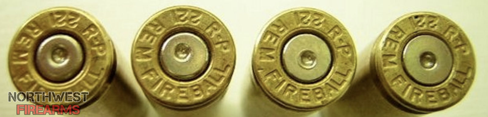

What do the primers look like? I saw that the pic was already decapped. Here is a primer on pressures. Note the increasing flatness ands cratering of the firing pin indentation as pressures rise.

no other signs of pressure, the primers were right in the middle of that picture guide (I use that bookmark too).

Notice the primers....

I did post a pic of the primers, they are good with no signs of pressure there.
Sorry, I missed that picture. They all look pretty "normal." But with over charges, you can have flattened or pierced primers - or - those that otherwise look normal.
