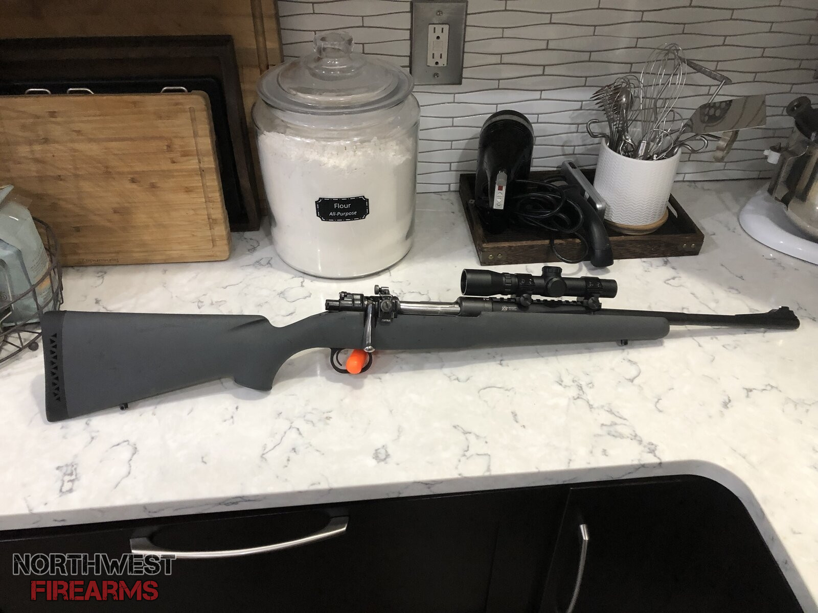

Well, after a few months of tinkering this is about what I've settled on. Still working out the kinks on a reliable feeding AICS solution so for the moment I'm running the factory BDL bottom metal in a Magpul stock. Barrel cut down to 18" and threaded, put a 9mm Lantac Dragon muzzle brake on it. XS tritium irons. Shooting minute of beer can at 100yds. It's about absolute blast of an experience.

How much does it weigh?
I don't understand your choice of optic, but that's you.

Wanted tritium irons because they weigh nothing, there's no batteries, no lenses to fog or get dirty. I hunt in very rainy conditions and dense woods, optics are more of a hindrance than anything, and if archery hunters can figure out how to get close enough to kill with a sharp stick, I can get within 100yds with this blunderbuss.
