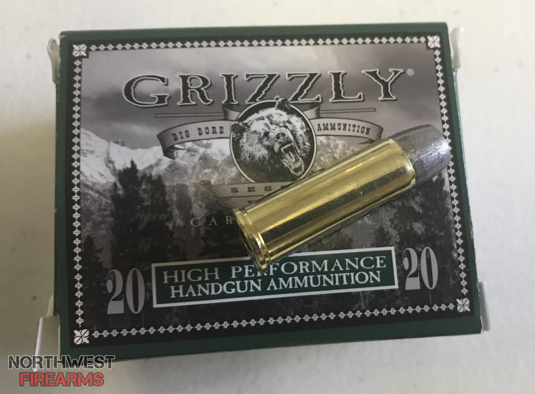

For a general purpose SD load that you may have to fire indoors or from inside a car? Even a .357 mag fired under such circumstances puts you in serious risk of broken eardrums and temporary or permanent hearing loss. The .357 mag is about twice as loud as 9 mm, .38sp, .44 sp, .45acp, and 45 colt. The 44 mag is way louder than the 357 mag. If you are carrying a .44 for self defense under circumstances that might include firing indoors or from the inside of a car I suggest you load with .44sp, not .44mag. For example the 44 sp Speer Gold Dot JHP if you need an expanding bullet. Or the Grizzly 44sp. 260 grain Cast Performance wide flat nose hard cast at 950 fps (521 ft. lbs.) for maximal penetration. That is, .357 mag powe kevel but with a much heavuer fatter but also subsonic bullet. Don't know where you can buy the Gold Dots these days. The Grizzly load is on the Grizzly Cartridges website page 27 and is in stock. And they are a local manufacturer.
