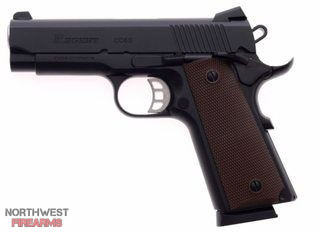

Has anyone owned one of these? If so, any good or bad comments about them?
I own a few 1911 Colt, Remington, and S&W built .45's, and looking to buy a compact 1911 style .45. I found these Tisas in a 4" barreled compact with a lot of nice custom features at Bud's Gun Shop for $370, and thought it would make a great compact carry gun. They're presently out of stock, so I put my name on their email list. Just looking for input while I wait to see when one comes in.
Mine is all steel but they have them with lightweight lowers as well. The gun is very well made.
I like mine but the factory mec gar mags barely work, Colt mags work well and I purchased a Dan Wesson mag and that one does not work at all.
I purchase the 1911 "Tank Commander" (4.25" barrel).
First impression is that the recoil spring is really "heavy"; racking the slide is upper body exercise!
Also, as mentioned earlier, the provided mags seem cheap; they don't hold the slide back on empty and the follower sticks out the front when empty.
Otherwise I'm extremely happy with the purchase.
