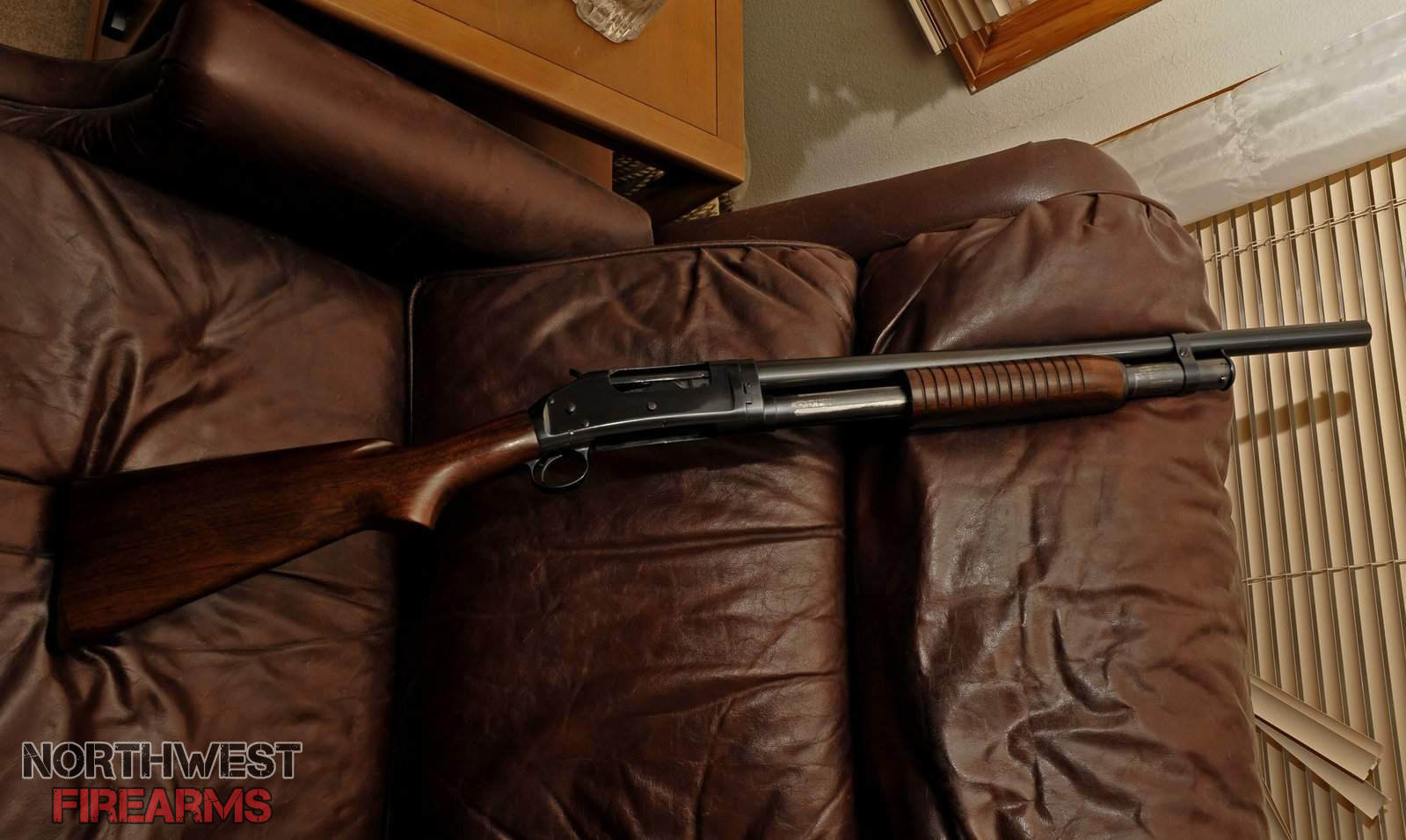

Then take a look at my Dad's 1897. It is in quite pristine shape. It is a take-down model with original 20 inch barrel too.
I want to put it up for sale, but am having a hard time figuring out what it is worth. Its serial number is real high ( over 1 million ), so it is one of the last model 1897's that Winchester made.
Maybe I will take some close-up photos, and see if I can get some help in figuring out what it is worth.

What does it say on the barrel in the way of a choke configuration?

If it said "CYL" then it would not be choked at all, and that would designate a riot gun barrel from what I've read about these shotguns.

Interesting that it's basically a factory 20" barrel "riot gun", yet has a modified choke commonly used for hunting ducks. No wonder you are having a hard time figuring out the value. Makes you wonder if it was a special order for use around lakes with heavy underbrush for easier maneuverability.
You can also adjust the barrel to receiver lock up on the take down models if yours is a little sloppy.
I am glad that you said that, I didn't know. I thought that I had ruined it on a hunting trip to Treo ranch in Heppner, OR about 9 years ago. It was 15 degrees outside, the shotgun froze up and I couldn't rack the slide. After that trip, it was loose fitting between the barrel and receiver. Finding the Midway USA video, and adjusting the barrel fit, all is well.

A 20" barrel marked modified is most likely a cut down.
That would be true if the barrel isn't choked, but he said it was an original 20" barrel so I assume it does have a choke (easy enough to verify). You used to be able to order shotguns in your desired barrel length/choke from Winchester.
Yep and I didn't assume anything not mentioned. If the barrel is 20" long and marked Modified then it is MOST LIKELY a cut down. And it can be both the original barrel and a cut down.
Didn't say it couldn't possibly be a rare special order choked 20" barrel.
So how does one verify that a shotgun barrel is choked or not?? This is not obvious to me.
If it was such a custom order gun, its resale value would be more, no? I sure would like to figure this matter out.
From the serial number I have been able to determine that my Dad's shotgun was made right near the end of the production for the 1897.
If the barrel has been cut down and the original choke section removed, then the easiest way that I know to verify that the barrel has been altered is to remove the barrel, then take a 24" length of bare stiff copper wire (12 gauge house wire will do) and bend an ell leg at one end of the wire so it just fits side to side past the chamber where the shotgun shell is inserted.
If the wire fits smoothly all the way to the muzzle without constricting, then there is no choke and that will confirm that the barrel has been cut down.
On the other hand, if the wire starts to constrict near the muzzle, then one would assume it's a modified choke as marked on the barrel.
You can also measure it. The cylinder bore of a Winchester shotgun barrel is .730". If it has a modified choke (.020" constriction) then the muzzle end ID would measure .710". If you don't already have a vernier caliper, something like this digital one will work and easy to read- http://www.amazon.com/Carrera-Preci..._5?s=industrial&ie=UTF8&qid=1426264712&sr=1-5
You can also pattern the shotgun into a 30" circle at 40 yards, but sticking a caliper on one end is much easier.
And then there is the old fashioned "dime method". I found a video to show you. My M12 cylinder bore has about as much play as this guys improved cylinder bore (Mossberg 500) . So a dime will be pretty snug with a modified choke in your '97
