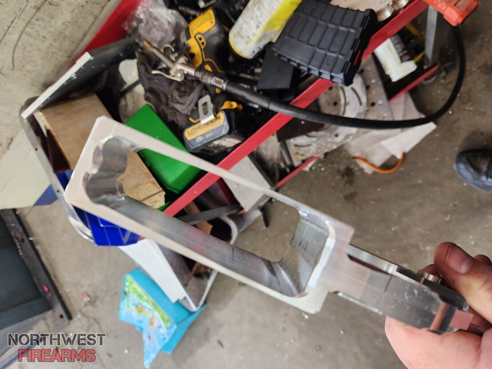

I had this want to reflow 6061 in my old heat-treat furnace so I did...about 6 times. Eventually I had to raise the mold to get the required amount of alum, open top molds shrink like crazy in the middle. Stack old bar rems in heat to 1250 degrees, stir and cool fast then pull bottom of the mold off and remove with press. Heatreat at 450 for 6 hours. I'm only doing the lower this way, the upper will be proper bar stock.

Not really happy how the lower turned out, lots of things went wrong and found some not so great sections of cast. It's functional but no pics till it's coated lol. Ordered some real billet for V2.

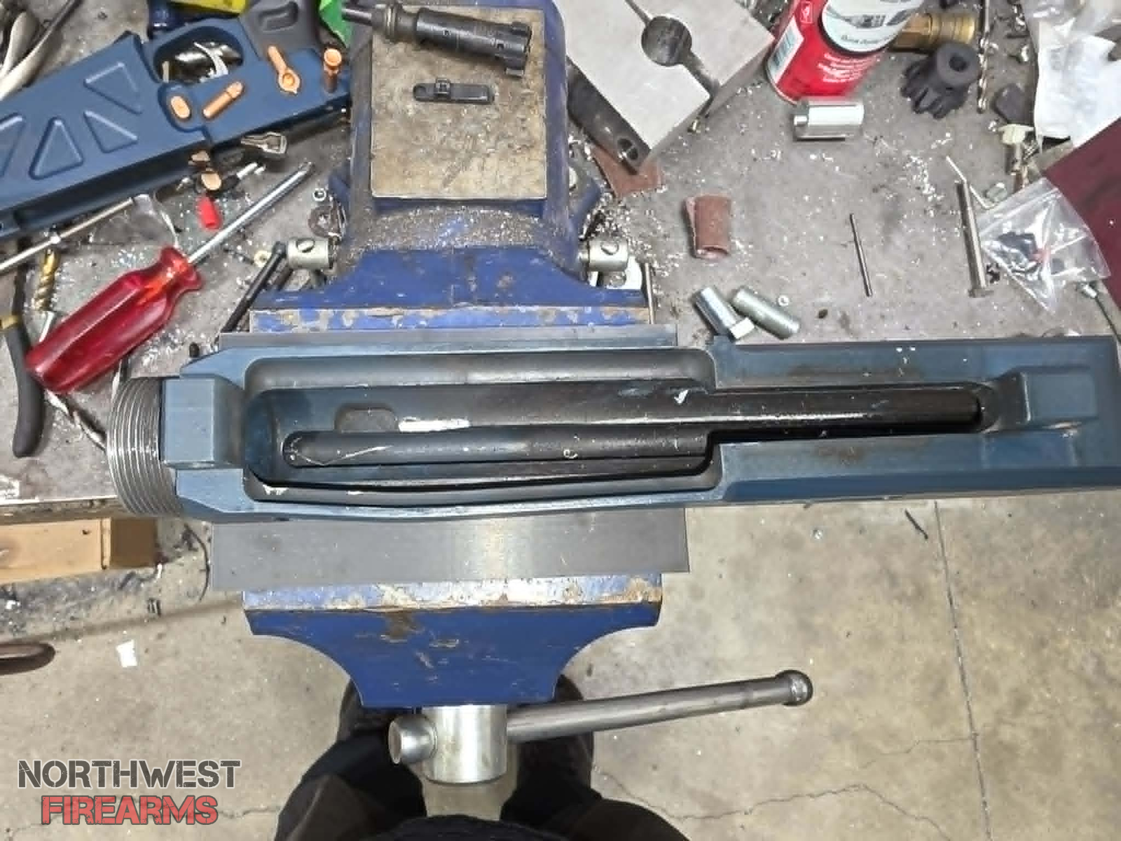

The upper is great, most went as planned... should have stripped the head guard fully.
I had a Tikka 300WM barrel from my T3X so I lengthened the tenon (adding timed threads even) and sleeved a gas block to fit the largest allowable journal. Rechambering a AR10 308 barrel seems like a good future plan. But it's a barrel for now.
The lower is ugly , crap happened at several phases but I managed to get it working.

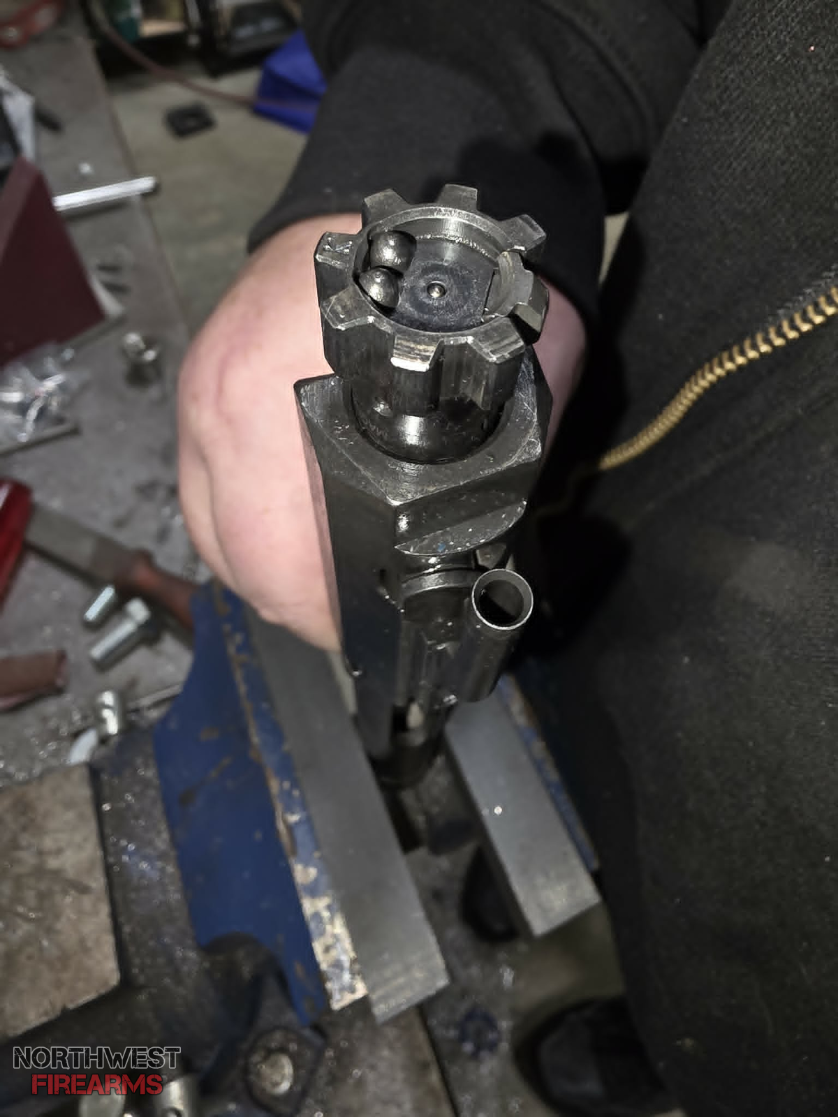

Bolt carrier needed a pocket for the Omen firing pin spring so I silver soldered an endmill in a long extension, it worked. Pinned a small extension on the back, made clearance for the hammer and coated it all in Microslick.
Getting close to test firing. Hopelly it's not a jamb-o-matic with extra FTE and FTF.
