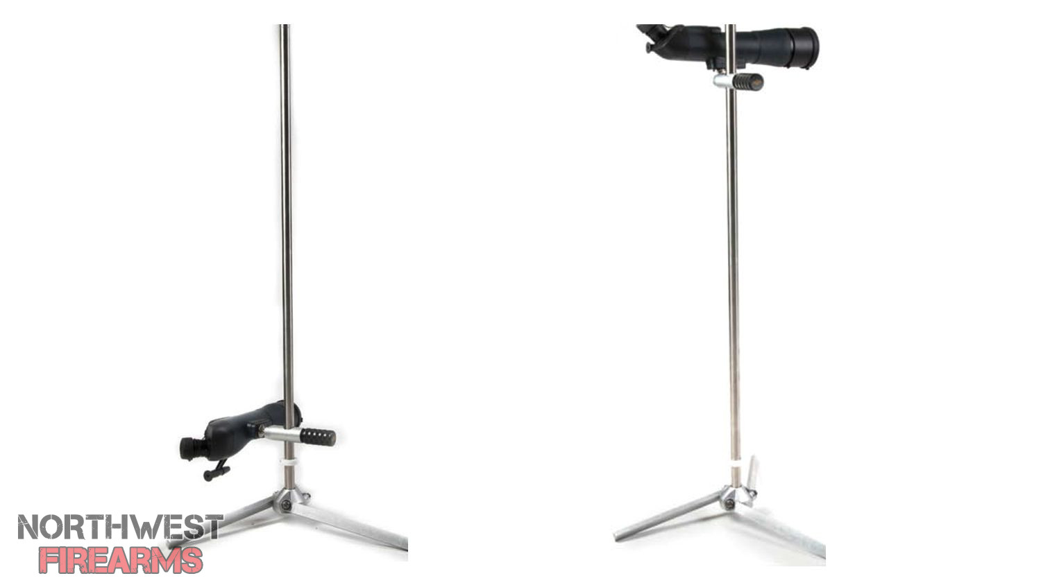

I have the Ray Vin scope stand. Easy one adjustment knob. Adjustable height for shooting
prone and sitting. Tri-pods get in the way.

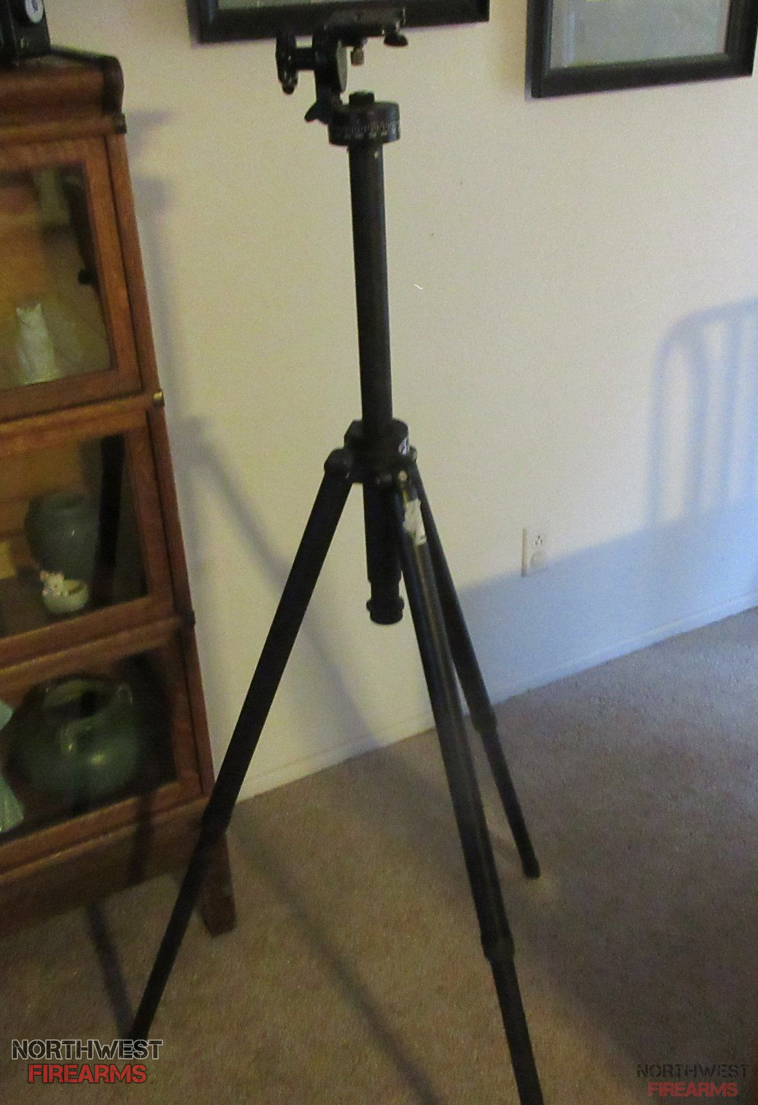

You can add a weight (sand / lead) bag to many tripods. Mine has a "hook" at one end of the column for just this purpose. Use water if you need to pack in any distance.
See the hook in this image
I totally agree with ron on this! Camera tripods don't have a place on a gun range. What will end up happening is someone will trip over the splayed leg and down will go the scope. I've seen it several times. I've heard of it happening many more! Camera tripods take up far too large of a footprint, and interspersing this with shooting benches, gear bags etc. etc. creates a real mess when trying to move around.
A stand like ron shows (I have the same one and love it) are used almost exclusively by highpower, smallbore and air rifle competitors for a very good reason beyond safety of the scope. These type of stands allow you to move the scope in very close to your shooting mat or your bench. When properly positioned all you need to do is slightly tip your head off the gun and use your non-aiming eye to spot. Then slightly tip your head back to the rifle and shoot. No contortions, no messing up your positions and better quality shooting as a result.
