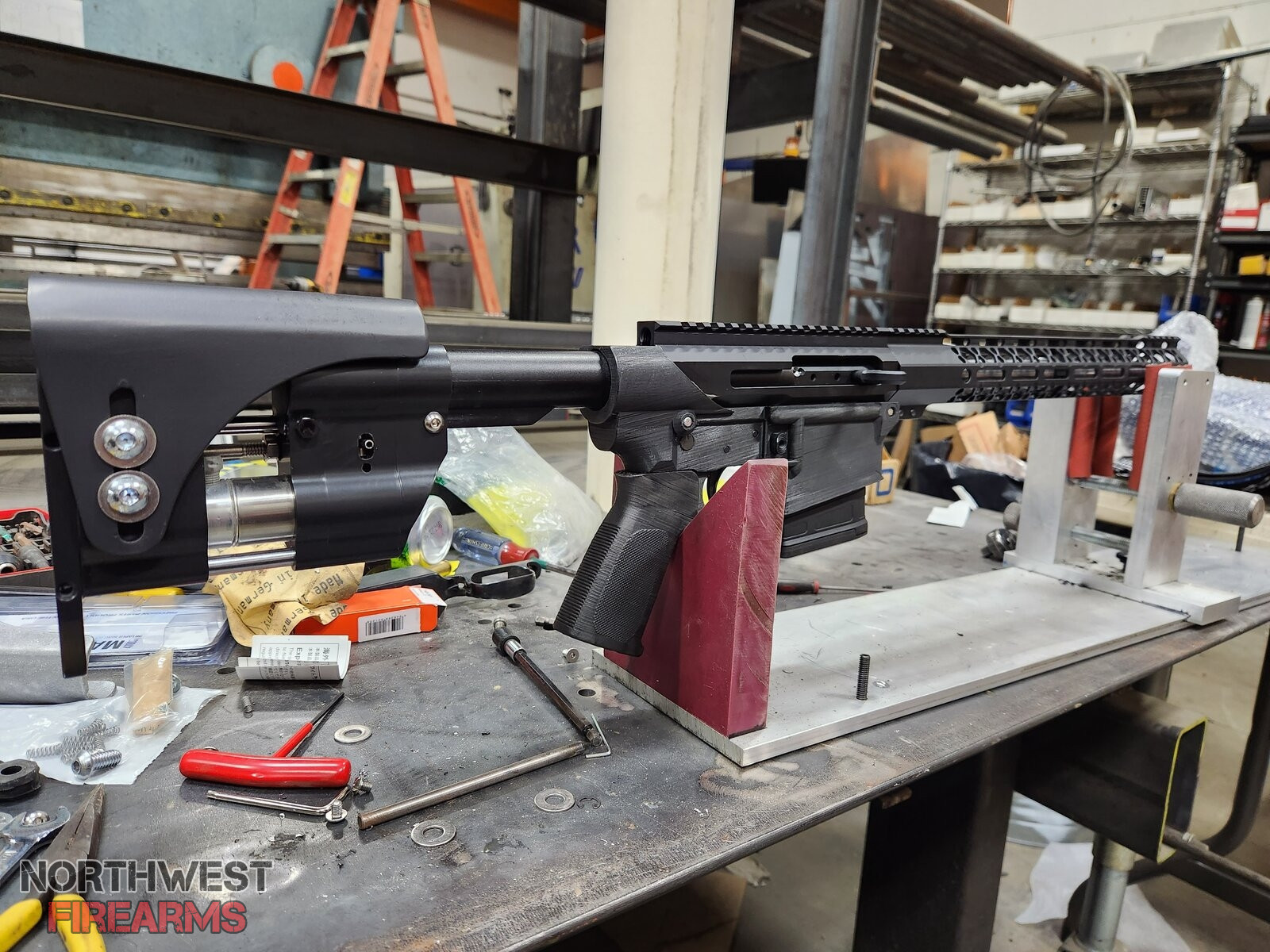

Handled on at SHOT, felt awesome. Came home and started building one in CREEEDMOOREE.
Bearcreek side charge upper (modded), Grendel barrel rechambered to Creed, very modified SOCOM BCG (AR10 firing pin).
I pumped about 20 round thru the printed prototype lower with decent function.... next week I hope to start carving a real deal lower out of alloy.
I imagine this is a one off personal build, but I'd be a bit concerned about bolt lug failure. .308/65CM max pressure is around 27000 psi higher than the SOCOM and other AR-15 cartridges that use the same bolt face. Another related issue with the small frame short action designs had to do with overpressure events. DPMS GII flutes the barrel tenon, SFAR ported the breech.

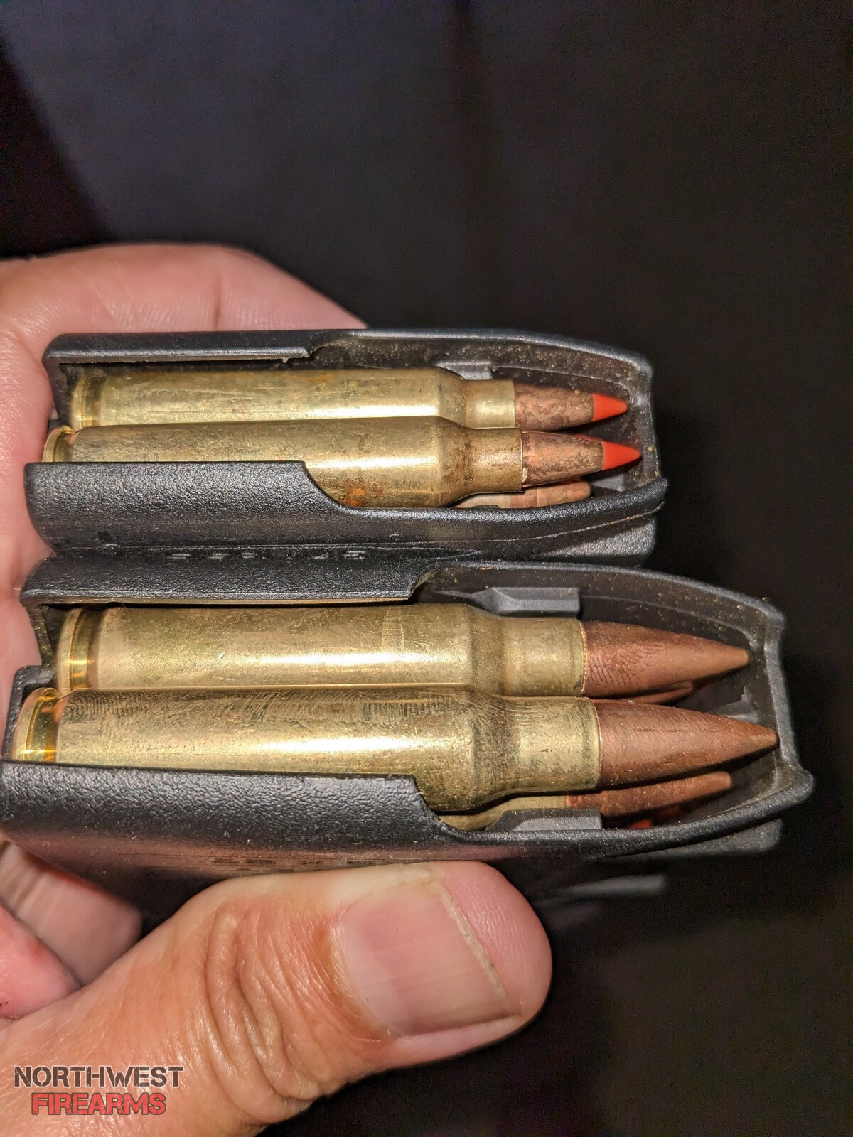

A 308 case might barely fit in Comparison.jpg to an AR-15 magazine. You'd have to buy a custom lower and custom upper just to fit the round in. 223 on top and 308 mazine on the bottom.
