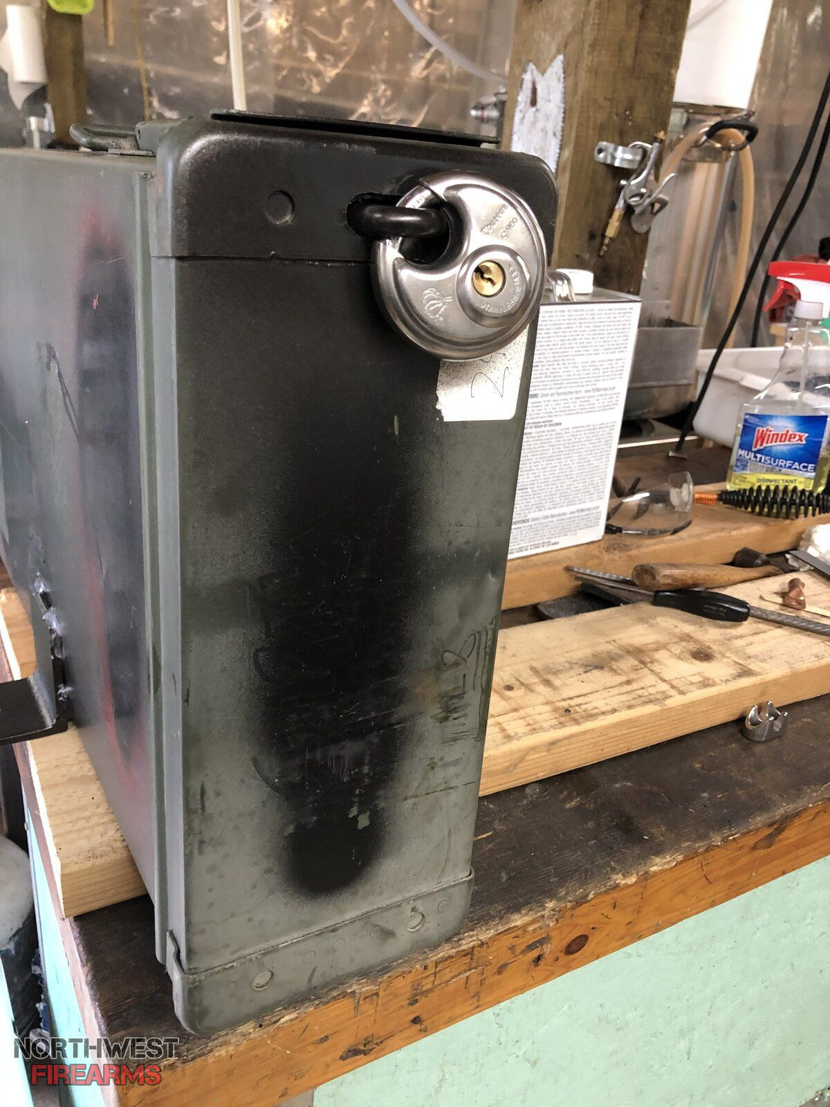

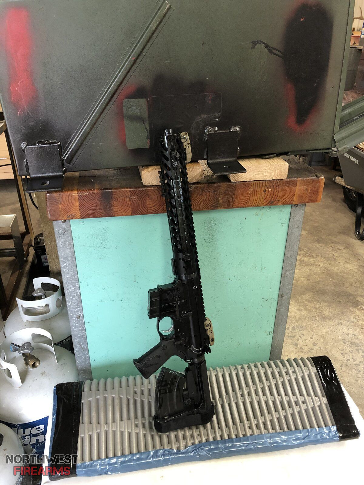

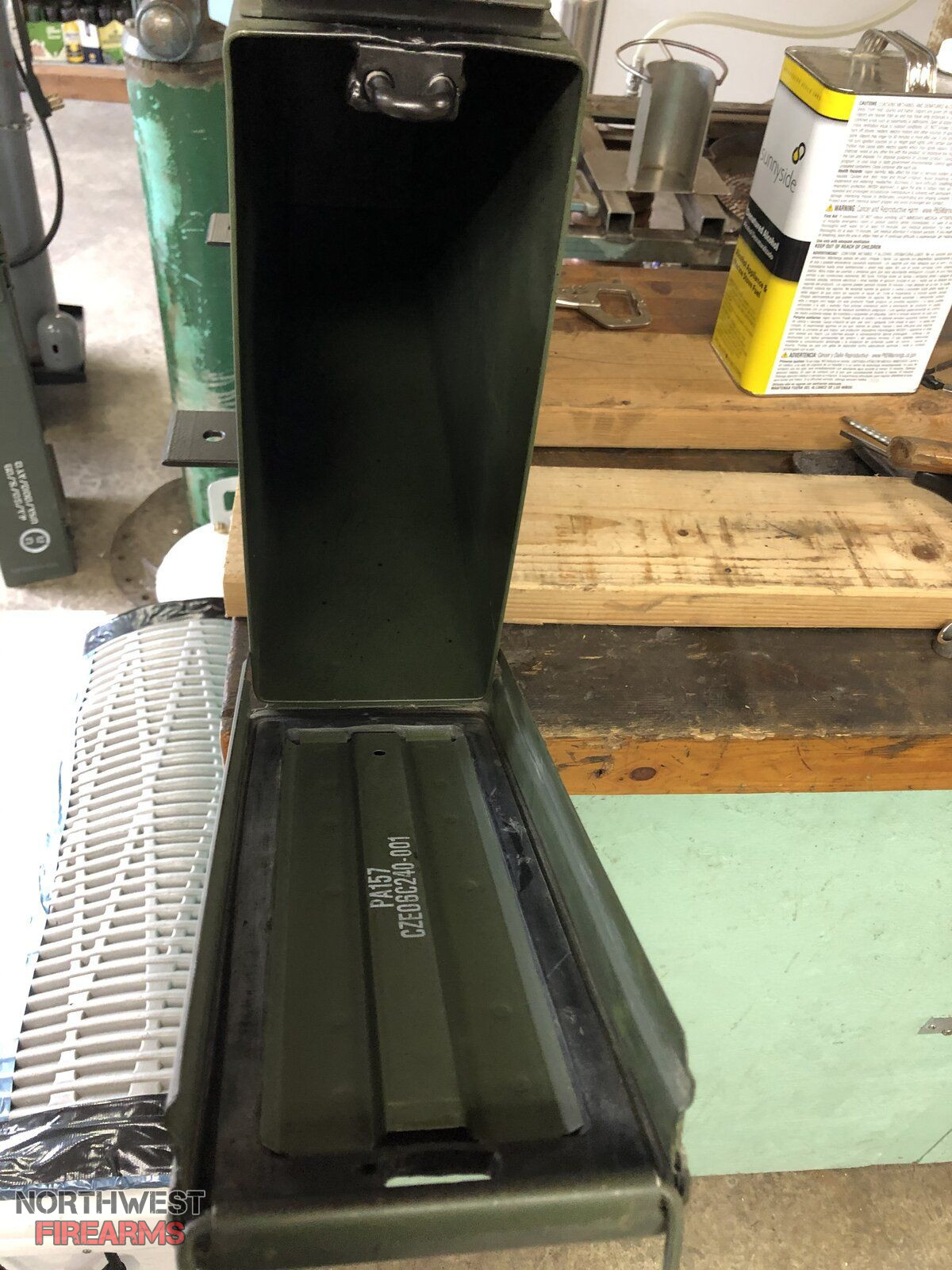

I do a lot of backcountry travel during the course of fishing and hunting adventures. I have been thinking of creating semi permanent safe vehicle storage for a 12" braced ar pistol in 7.62x39. This gun is short and handy, yet powerful enough for most situations that may arise. So yesterday I took a surplus 81mm mortar can and modified it by welding angle iron feet to bolt it behind the back seat of my crew cab pickup. I also welded a 7/16" ss ubolt to the interior and clearanced the lid so it comes out the top and can be locked with one of those circular type padlocks. Now I have been thinking about how to pad the weapon and keep it from rusting. Barrel is supposedly nitrided but looks to be more like a phosphate finish to me and I am sure it will rust if measures are not taken. I am thinking about taking a foam roll up sleeping pad cut and folded in half to fashion a custom fit protective sheath. I also would spray the interior of said sheath with boeshield or some other hi tech rust preventative. To hedge my bet I am also going to use one of those rechargeable eva dry desiccant type dehumidifier doohickeys. Anybody else do anything similar? Thoughts or comments?

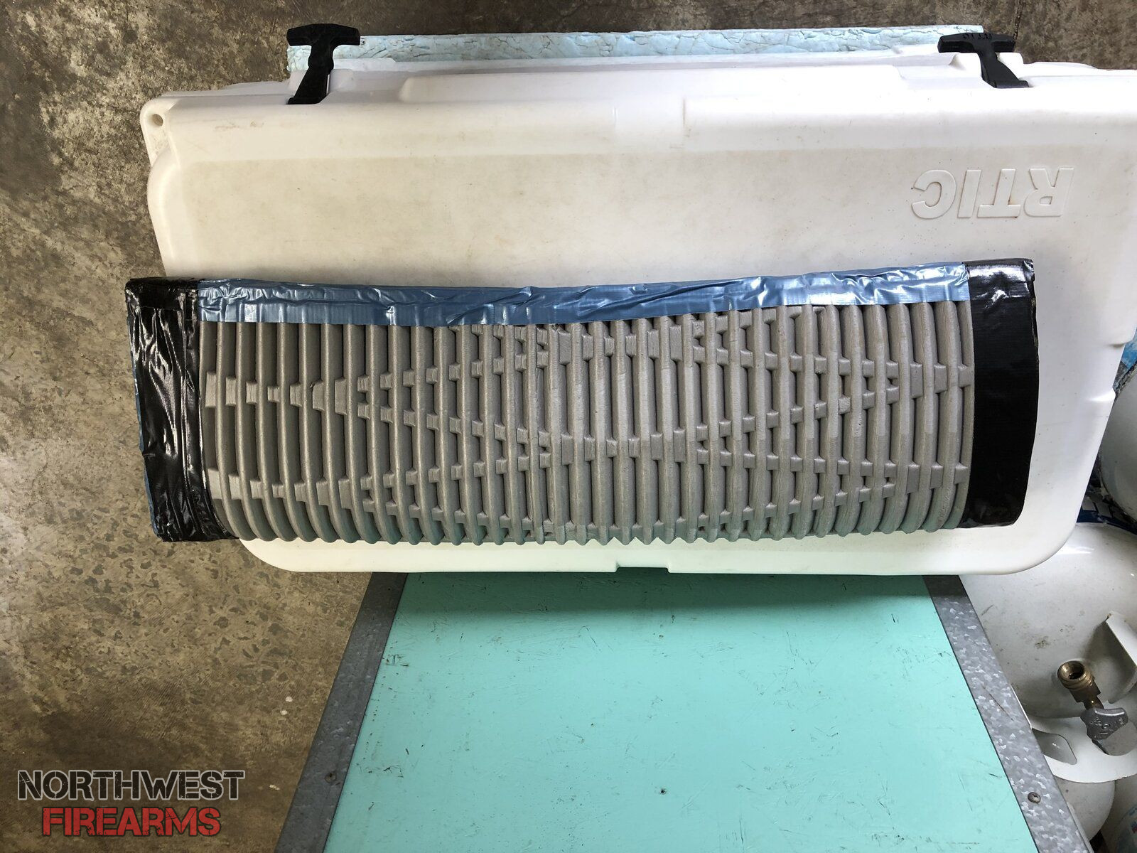

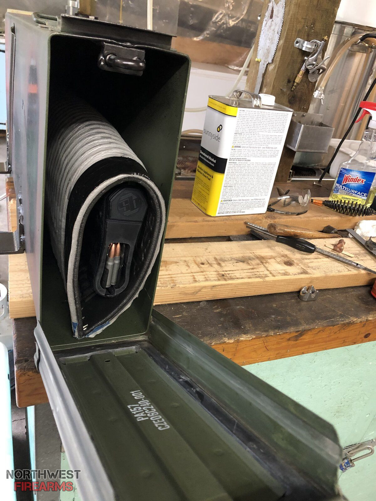

It will be in and out fairly often. Here is what I got so far. Sleeping pad sheath is sewn shut with kevlar thread and then sealed with 100 mph tape. Sprayed in a good dose of corrosion block.

Maybe so but this sleeve full of anti corrosion goo is fairly tight fitting and will protect the gun better. I will defer judgement after I use it for awhile and may end up modifying it more like you are talking about. It is a work in progress.:cool:

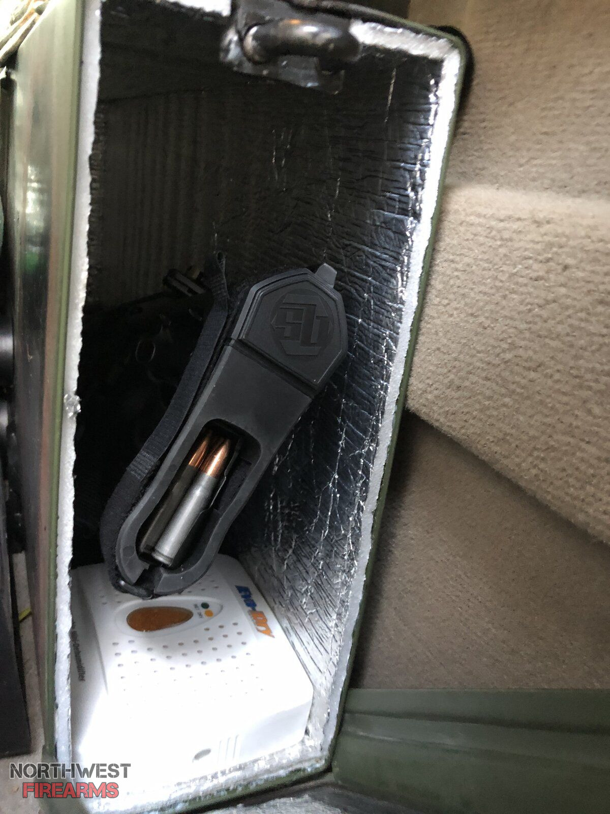

It only took a few times of trying to wrangle the thing out and then having it all gooed up to realize my folly. I lined the thing with some reflective foam insulation and put an evadri in with the ar pistol and it is is much easier to remove. We shall see how often I have to regen the evadri. 9056406E-1B4D-4D66-B081-F003F866011B.jpeg

Looks like a much easier way. Nice idea and should work great. Those are the same desicant deals I use for our safes. Love them. I for a long time used ones you had to put in the oven to dry. Saw these one day and as soon as I tried them I wondered why I waited so long. I just keep a couple ready to do in ziploc bags. When one needs recharge pop a new one in and plug the other in till it's done.

I took my truck gun out of the storage box to take it to the range today. It had been in the box for eight days with 5 or 6 openings in that time period. The Evadry is still showing orange and no sign of rust on weapon so back in it went after a couple mags run through it. :)
Just an update on the eva-dry. It went an entire month and still was showing orange although starting to get some greenish tint so I regenerated it. This is pretty good service as it has been the wettest part of the year and box was opened probably 3 times a week on average. Gun shows no signs of rust.
