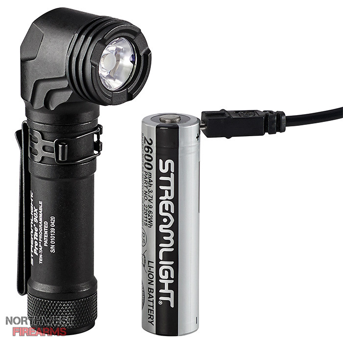

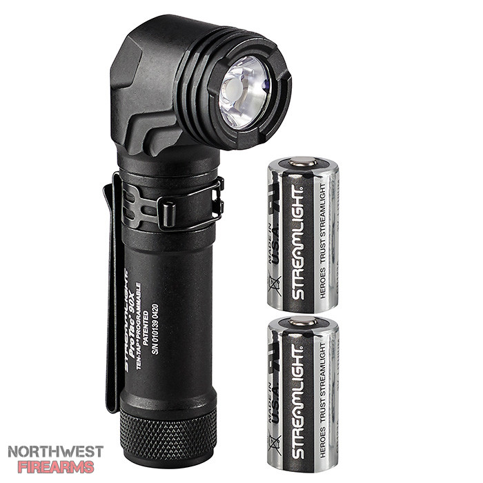

The streamlight products I've been buying are dual fuel. 123As or their rechargeable double cells.
Streamlight-ProTac-90X-Right-Angle-Flashlight_5.jpg Streamlight-ProTac-90X-Right-Angle-Flashlight_3.jpg
I'm more worried about the construction/quality/durability/output/candela/lumens of the light over rechargeable/replaceable forms of energy.
Just have spares for whichever direction you go and swap them out on a regular basis which will be dictated by how often the light is used.
