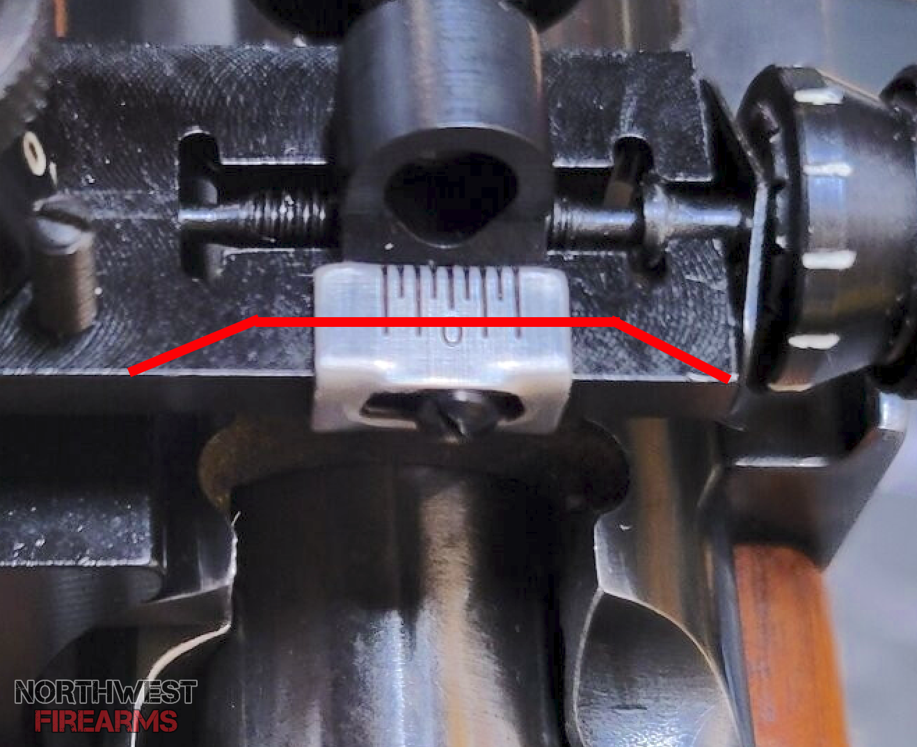

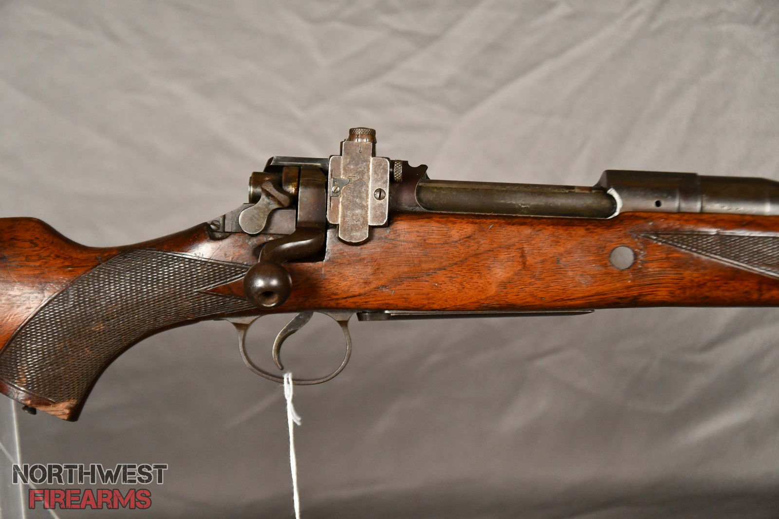

Northwest Armory has a 1917 Enfield (Winchester) up for auction right now on Auction Arms and it is also sporterized somewhat similarly to yours. It has a Redfield sight on it.
Somewhat similar, but the smith that did that work left part of the "ears" intact, and the sight mounts to them. That's why it is mounted higher than mine and doesn't require any stock inletting. It's probably a flat-sided sight like you might put on a lever gun. Mine is drilled and tapped directly into the rounded receiver, so it needs a sight with a similarly curved surface.

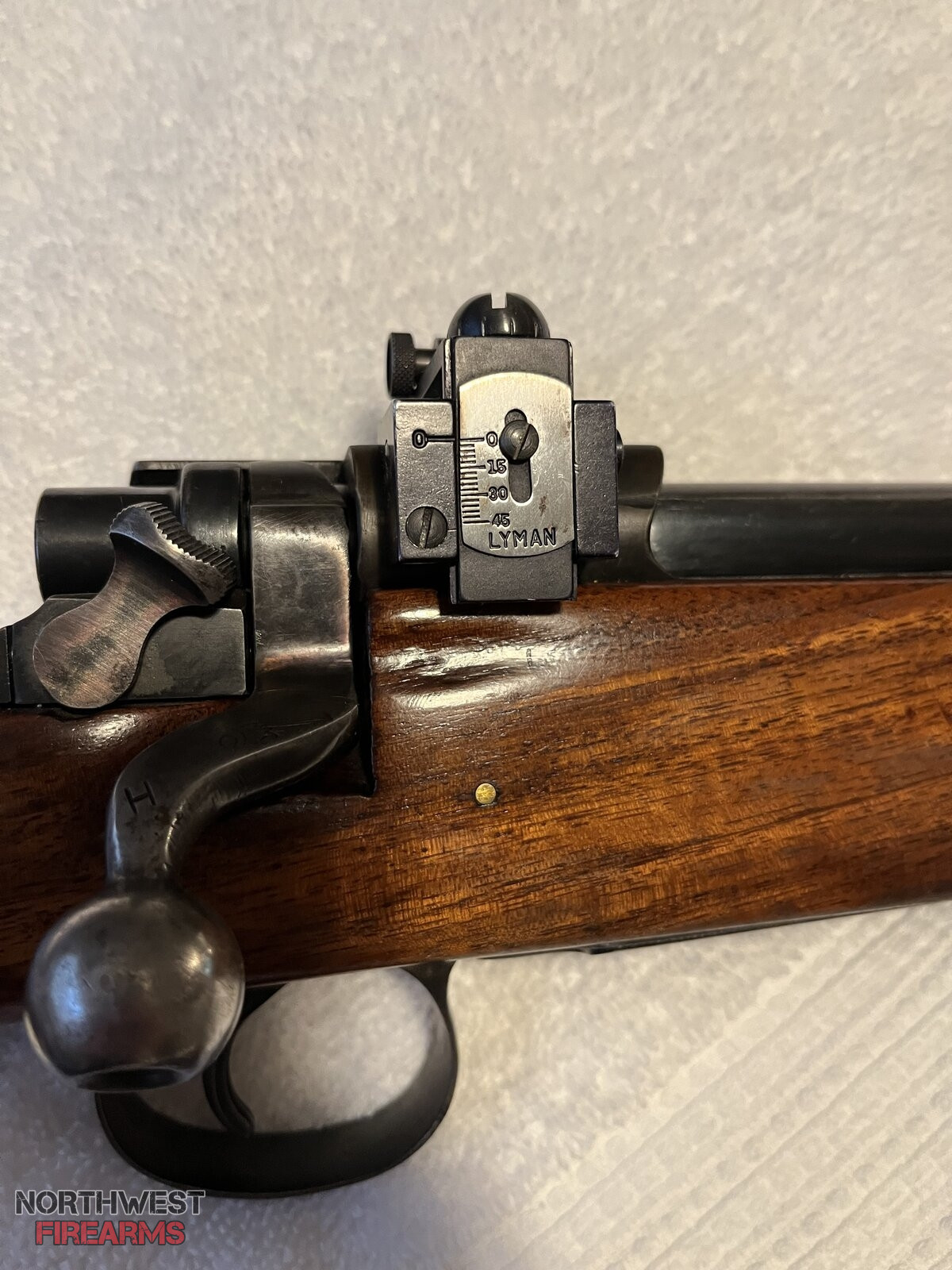

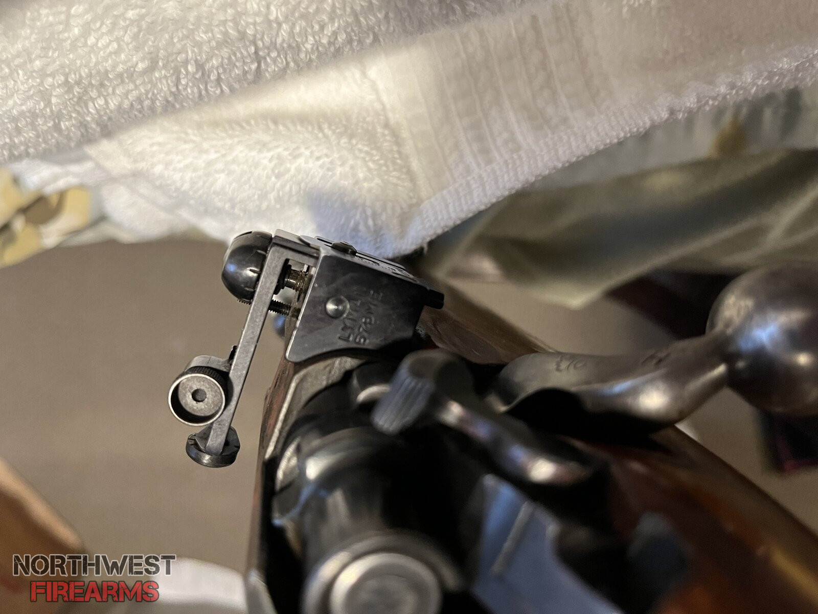

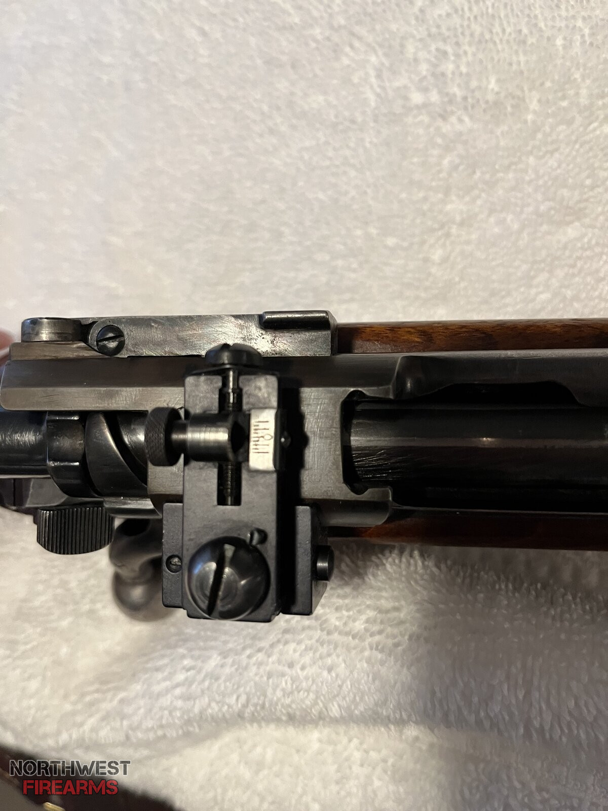

Mine wears a Lyman 57 SME, but it appears to be mounted a little further back on the receiver than yours.
I did not install the sight, it was on there when it came to me. If your goal is to use the stripper clips, maybe drilling and tapping another hole further to the rear , or two holes, would get you what you are after?
