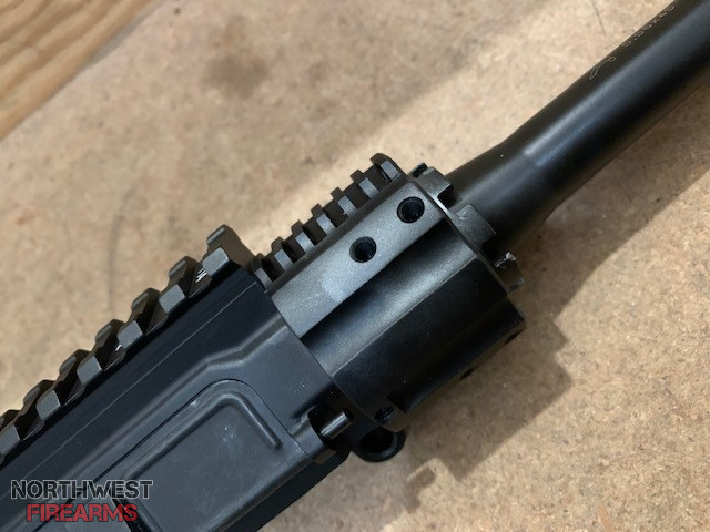

I recently purchased a very nice Aero Precision 14.5" upper with an m-lok handguard. I took the day off and was excited for to put together a new build. My plan was to change out the m-lok handguard for a Midwest Industries handguard, but then I ran into this (see photo). This is part of the upper and cannot be removed (!)
Do all free float m-lok handguards have this? Can someone recommend a free float upper that *does not* have this feature, can be taken apart with a standard armorer's wrench, and will accept an aftermarket free float handguard? I see PSA is running some deals on uppers.. I am now going to have to sell my Aero Precision upper at a loss and this "fun" budget build has become more expensive and time consuming than I wanted.

It's an M4 E1 upper, so you have to run a compatible handguard.

I think if you're not familiar with free floated uppers that info is confusing. It makes it sound like it fits many types of handguards.
That is their proprietary barrel nut (most handguards are these days). I would purchase their barrel nut wench to remove it. It looks like you have use one of their handguards and if you are there is no reason to remove it unless you want to confirm whether they used AEROSHELL 33MS or not (get some if you don't have some and intend to replace the barrel nut).
https://www.aeroprecisionusa.com/m4e1-barrel-nut-wrench
Handguard mounting platform is forged into the receiver, just one more reason I'll never buy one of these uppers.

Which one? They about 50 different ones. You'll need a different upper.

Looks like I do need another upper. I think I'm going to keep the Aero upper for now and just see how it shoots, maybe it will grow on me. I wish I had more time to research everything thoroughly. I could have avoided this $400 mistake.
Just to clarify for anyone reading this later. The Aero Precision M4E1 has two options for upper receivers. You can get their Threaded version which will work with pretty much all standard handguards. The links shared say this, but figured I'd point out that this is specifically the Enhanced version which only works with their Enhanced and Quantum Series handguards.
@Aero Denezol incase you haven't looked into it, you can always pick up an M4E1 Stripped Threaded upper for around $100 and just swap over the parts. You'll be out another $100, but you could probably sell the Enhanced Upper for a similar price. Aero doesn't sell those stripped so someone might be happy to jump on the slight savings that doesn't mind picking up a forward assist and dust cover.

Propriety uppers, more so than free float. Yes this is meant to be used with their rails to free float a barrel, but I'd call it a proprietary upper over a free float upper as it is limited to their rails/hand guards.
What you have is a proprietary version of the Aero uppers available. They are proprietary for a certain selection of rails they make. You can buy these rails for regular uppers but not regular rails for this upper as it is proprietary in the rail it is made for.
Like others have said, a regular upper will allow you to use the Midwest industries rail you bought, this would not. Part of doing business with Aero I guess if your not aware they make proprietary parts.
Yeah I didn't know they made a threaded and a non-threaded version. For all the ARs I've owned this was the first free-float project I attempted to customize myself. Bit of an expensive lesson.
