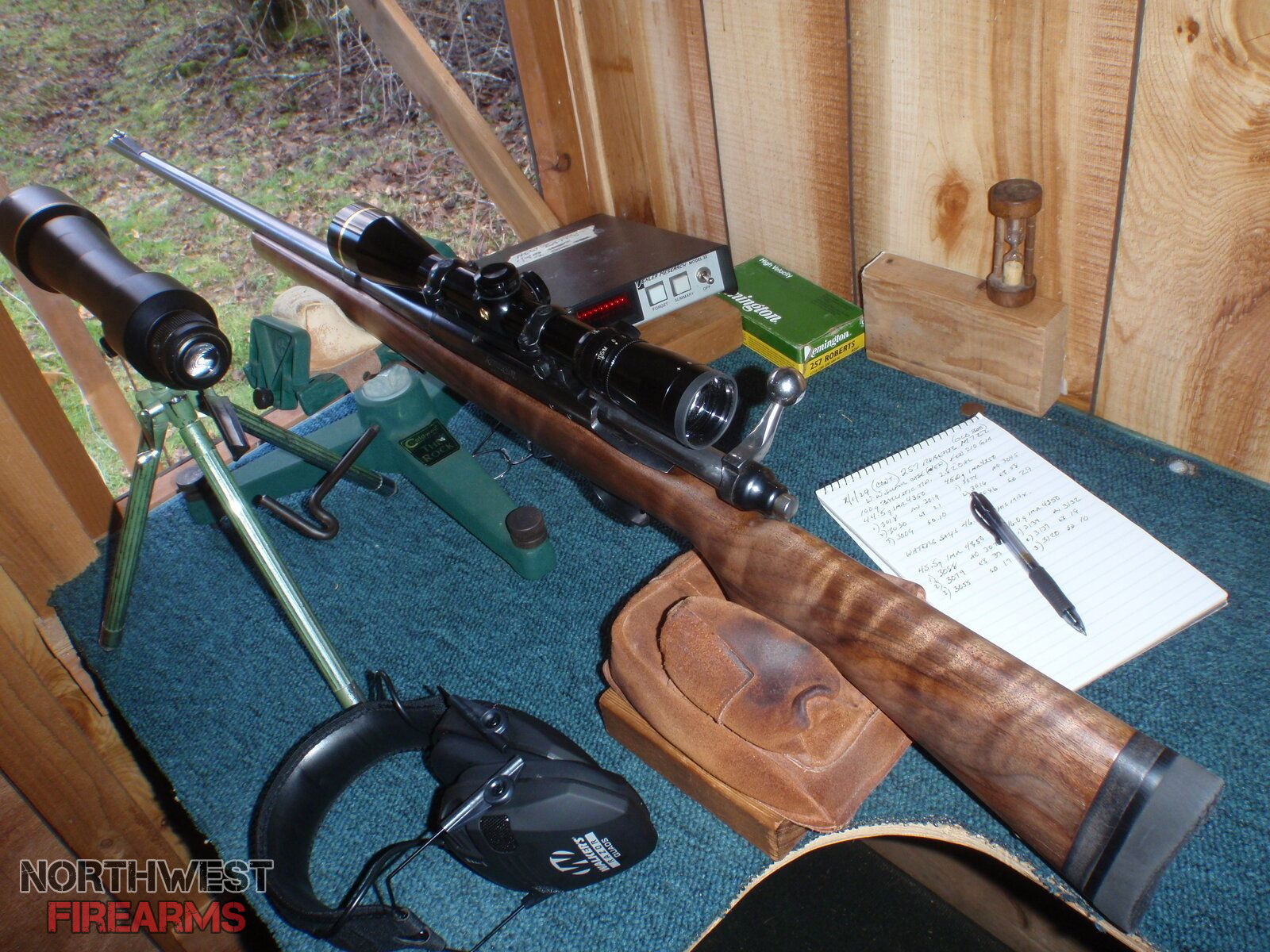

First break in our "Rains of Venus" weather, and "Ol' Bob" (of Basket-Case fame and recent Spa Treatment) hit the skids. Roadwork. Like Paul Newman in "The Fighter". Chances are, if this rusted hulk of a former gun did not fall into my hands (or similar), it may now rest in a landfill. At the very least, it probably would have never been shot again. He did very well, and looked good doin' it!
Ken Waters' Pet Loads once again lighted the way with reams of .257 Data AND Narrative. If you have decided to be a Handloader, this is THE ORACLE of careful, documented Handloading. Not always the answer, but he tells you how to find it.
A 100grain Nosler Ballistic Tip was the star for the day, but may not be the final choice. This was only 5 hours alternating between the load bench and shooting shack.
Ol' Bob's a pretty cool dude to spend a day with.
"Ol' Bob" on the bench and lookin' good doin' it! The rifle is a pussycat to shoot, trigger has been adjusted to impeccable, and the old boy performed on his first day out.

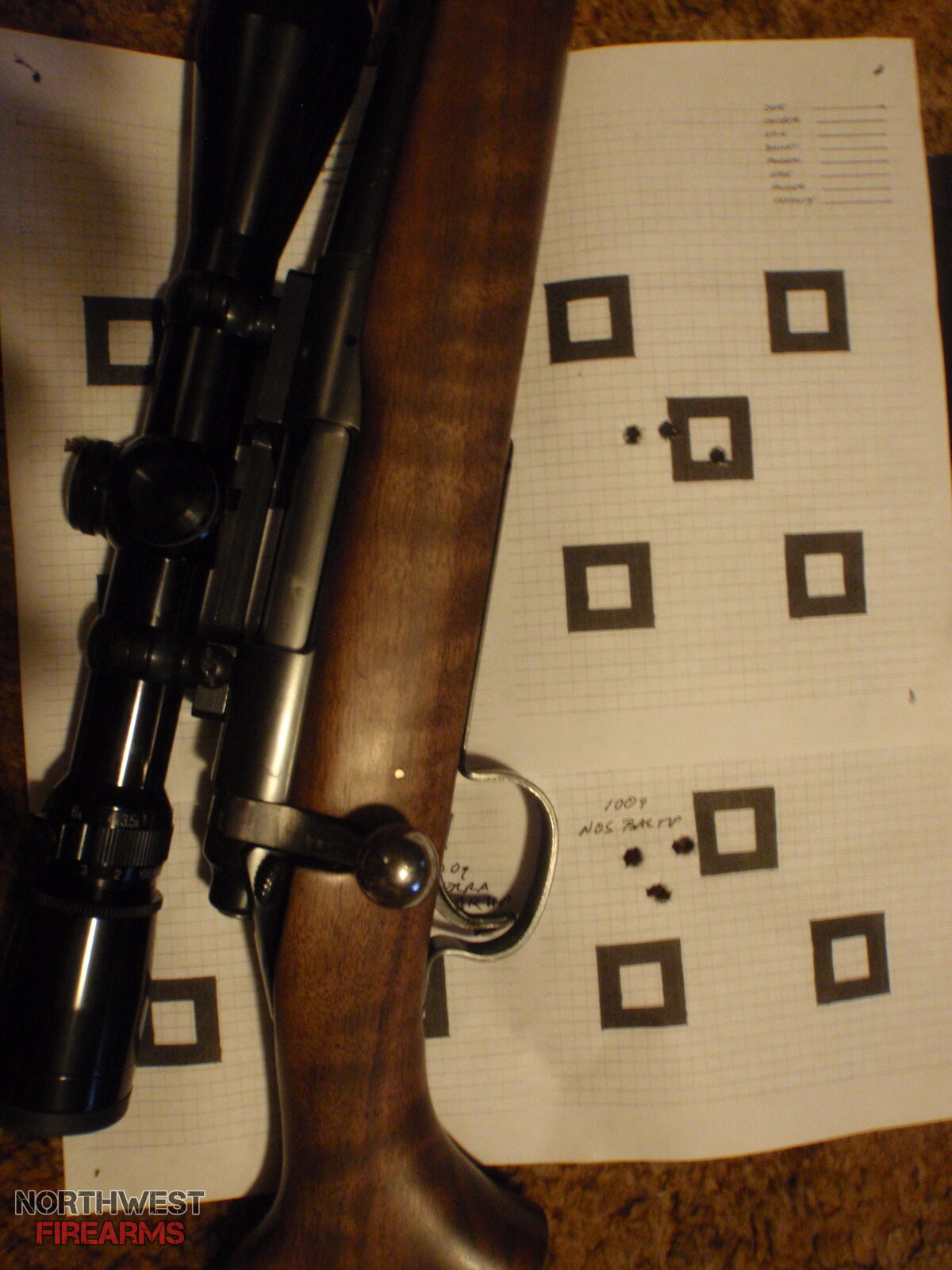

The two groups shown are the last of the day, and they are at Ken Waters' max, and develop 3140fps in this gun. He cautions twice in his ".257 Update" that this load (a full two grains higher than his earlier article said was a top load) should be approached with caution from two grains less, but that it showed entirely safe toward pressure and in his guns of modern manufacture.
To start, I cut three 100gr bullets loose at 2.5gr less powder than Waters' max and worked up from there. The surprise was that the Ballistic Tip did NOT show higher velocity (hence higher pressure) than the other two bullets (as can often be expected). The contender for accuracy was a Sierra MatchKing HPBT.

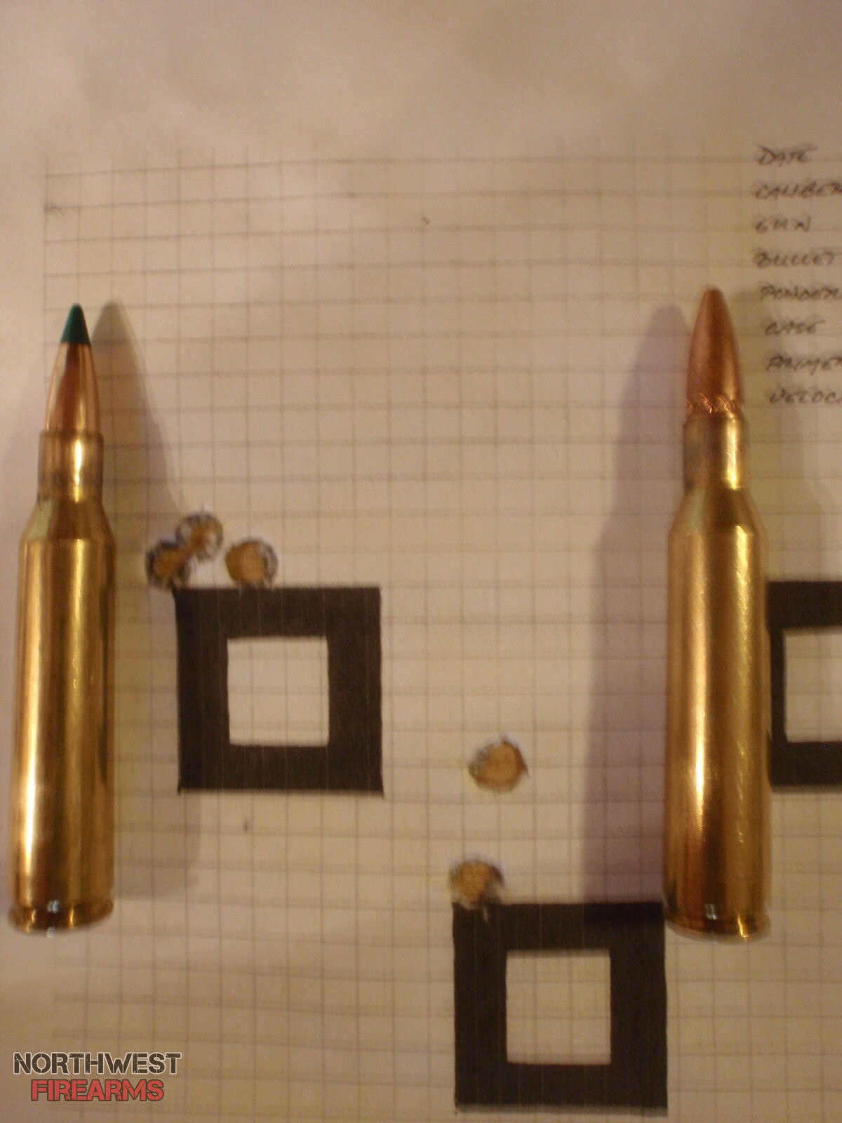

As speculated, I "re-tooled" on the loading bench toward lighter bullets, switched to a faster powder and readied seating depth adjustment.
The "quandary" of the .257 Roberts is best illustrated in a gun just like this: A true short-action, the cartridge itself needs to fit in the magazine, and that bullet seating depth may not approach the lands of the bore and/or can occupy useful powder space in the case. Maximum cartridge OAL for the Model 722 (dictated by the factory magazine box) is about 2.82". Factory stuff runs shorter.
The old round-nose 117gr load was at one time touted as "the only bullet that'll shoot well out of a Roberts" did well because it's ogive was so close to its tip, therefore close to the lands. The bullet was loaded pretty slow, but penetrated well and killed reliably.
But the real deer-killing reputation of the Roberts (along with the .250-3000) was made with the 87gr bullet. These were among the very first rifles that delivered "lightning kill shots" as a result of their high velocity. Taking it much further, Roy Weatherby would build an empire on the concept, and his .257 was his favorite.
So, "Ol' Bob" was fed a light lunch. He is now a scary rifle and maybe on his way to being a boring rifle.
Two 3-shot groups shot consecutively with two different bullets. Left: Sierra 90gr BlitzKing. Right: Remington 87gr PowrLokt HP. Same OAL/powder charge. Note the ogive on the Remington bullet much closer to it's tip than the sleek, boattail Sierra.
