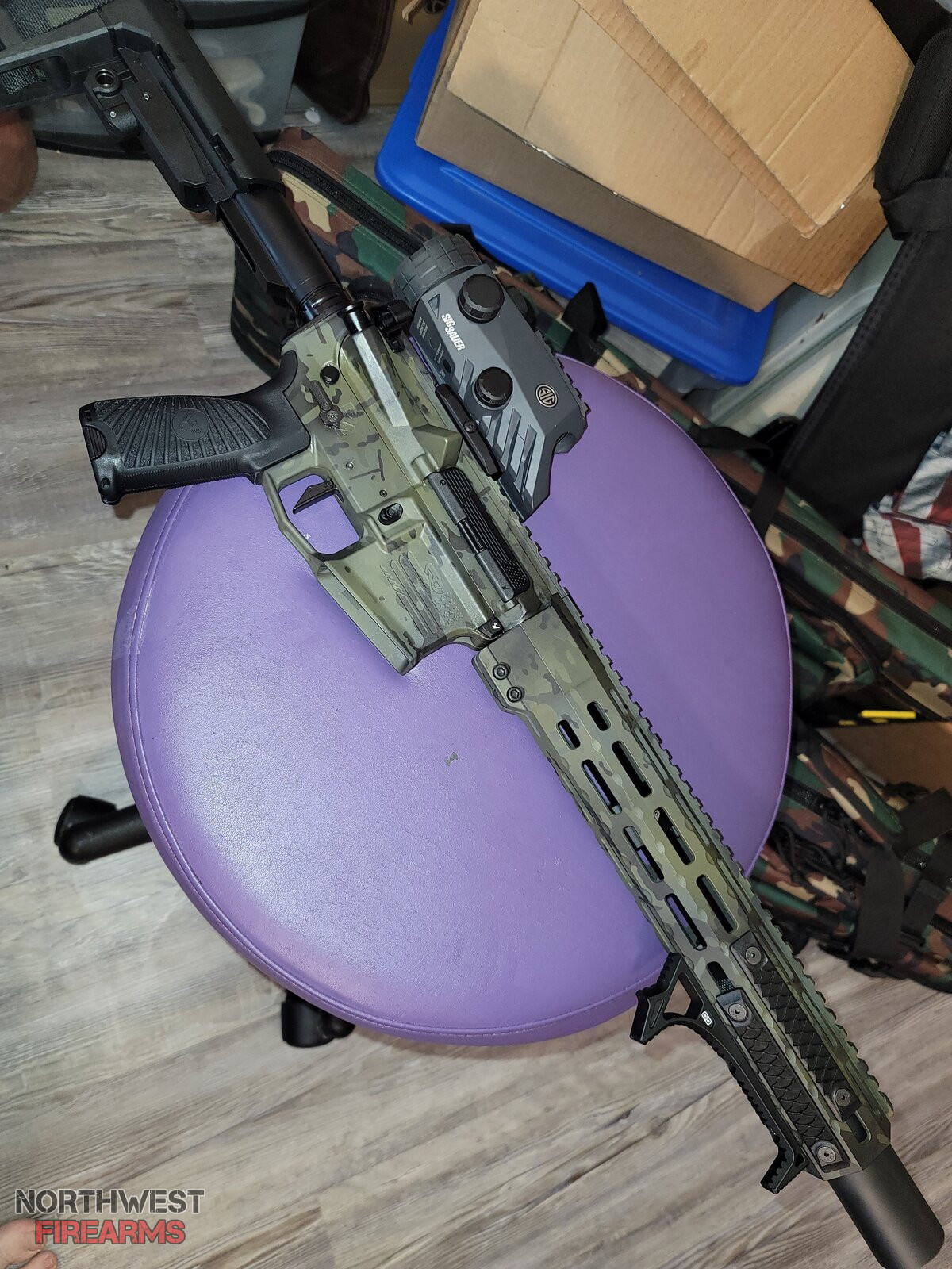

I was looking at their Match Series 9" Gunner Barrel. Wasn't sure how the thin profile near the breach would be.
I'm stuck between an 8.5" and a 10.5". I've decided on a criterion Core barrel I think and can't decide on length. It'll have a can on it full time so it'll already be longer than an sbr. Thoughts? Opinions?
