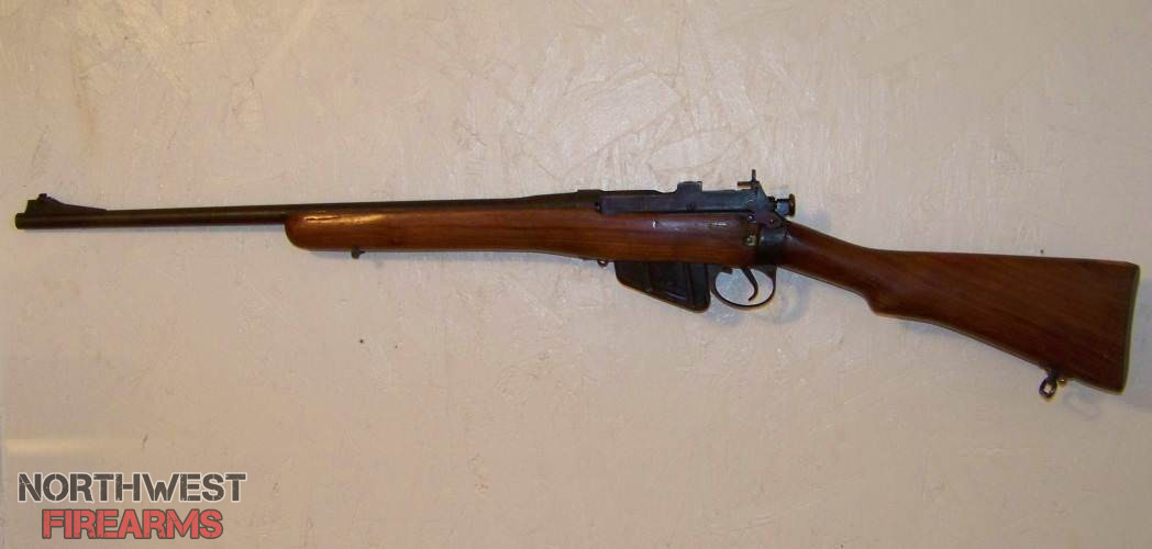

So I started this thread because I purchased a Ishapore 2A about five years ago to convert into a carbine along the lines of the No5 or really along the lines of what Golden State Arms did back in the '50s and '60s. GSA converted a bunch of Lee Enfields in to "Jungle Carbines". They even converted some No1 Mk3 Enfields and since that is what the Ishy 2A is based on I took their lead.
Here is the before photos:
Now the after photo:
Also made another rear sight that takes Williams Screw in Apertures.
Left the original butt stock since it's easier on my shoulder than my No5 with it's small hard rubber padded butt stock.
I guess it's more of a Scout Rifle except I'm not putting a scope on it.
This was a fairly easy conversion that shed about 2lbs off the +9lb rifle.
I think It came out ok.

I prefer the looks of a No4 or No5 action better than the No1 and 2, but getting rid of the original sights sure cleaned up the looks of this rifle. How long is the barrel now?
It's a darn nice looking rifle. Good job.

The barrel on the 2A is cut to No5 length, 17.8 before the flash hider was installed. The forestock and hand guard are cut to No5 length too. The hand guard is a cut down No4 hand guard I purchased from Numrich.
