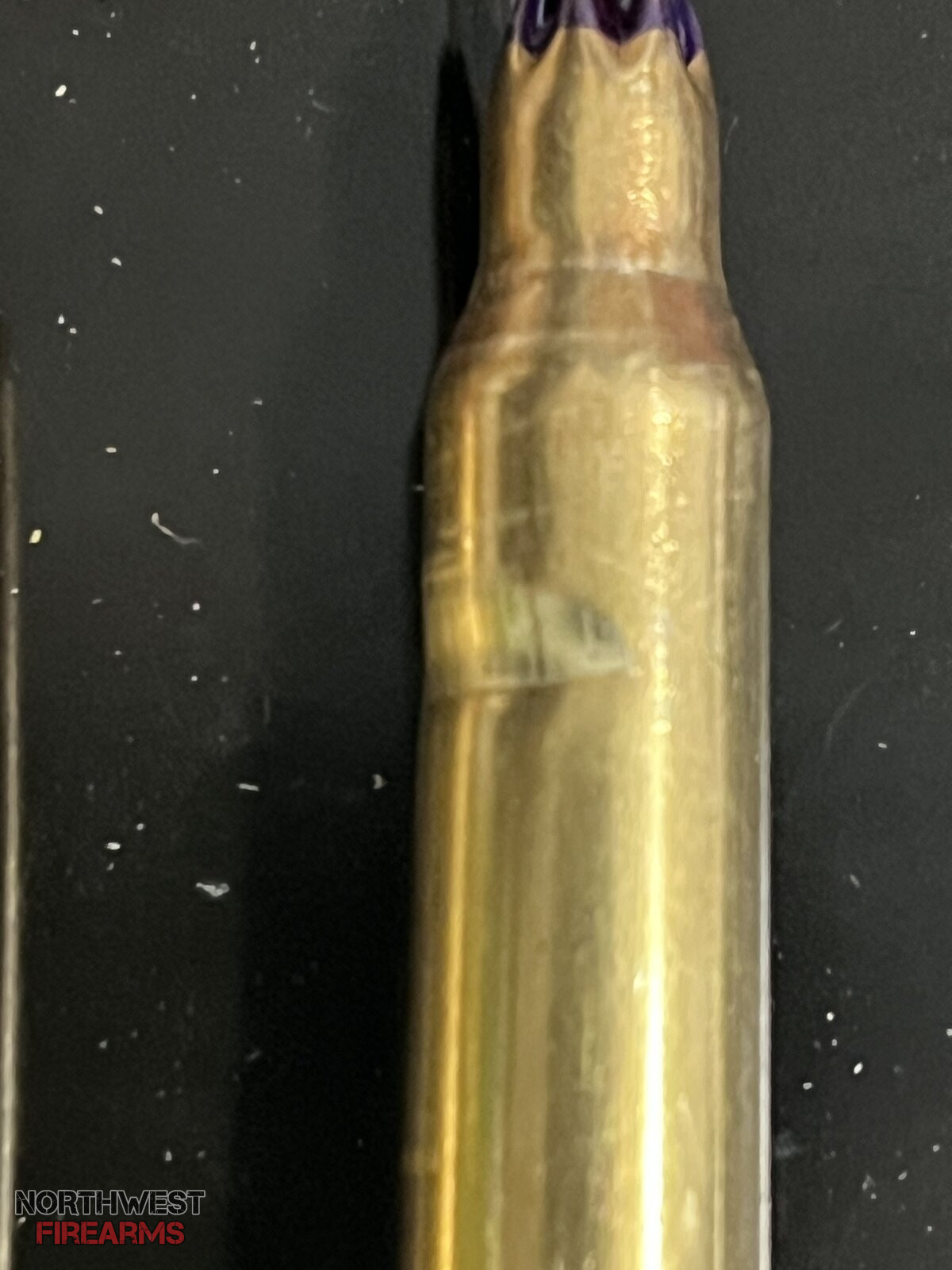

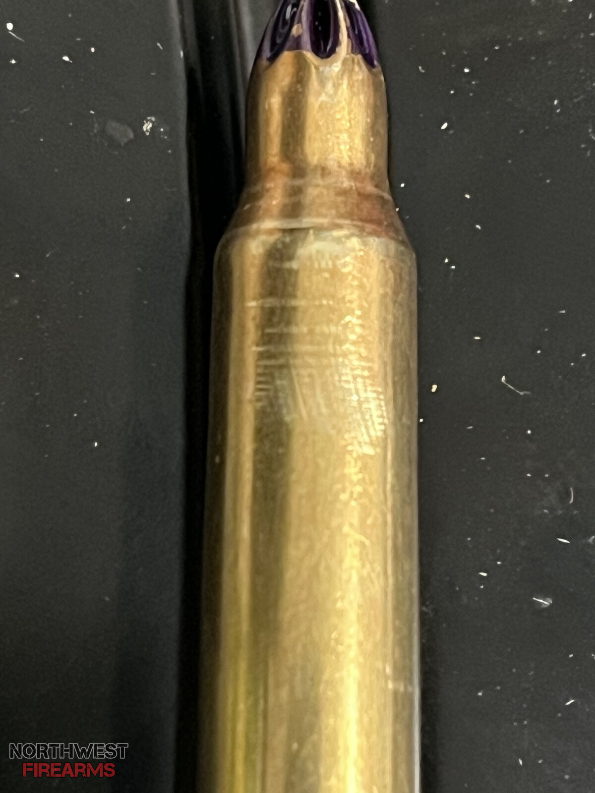

- It will cycle unfired rounds, although it doesn't fully seat the round into the chamber without some help on most attempts.
- The rounds that are ejected have marks/scuffs dents like it isn't smooth.

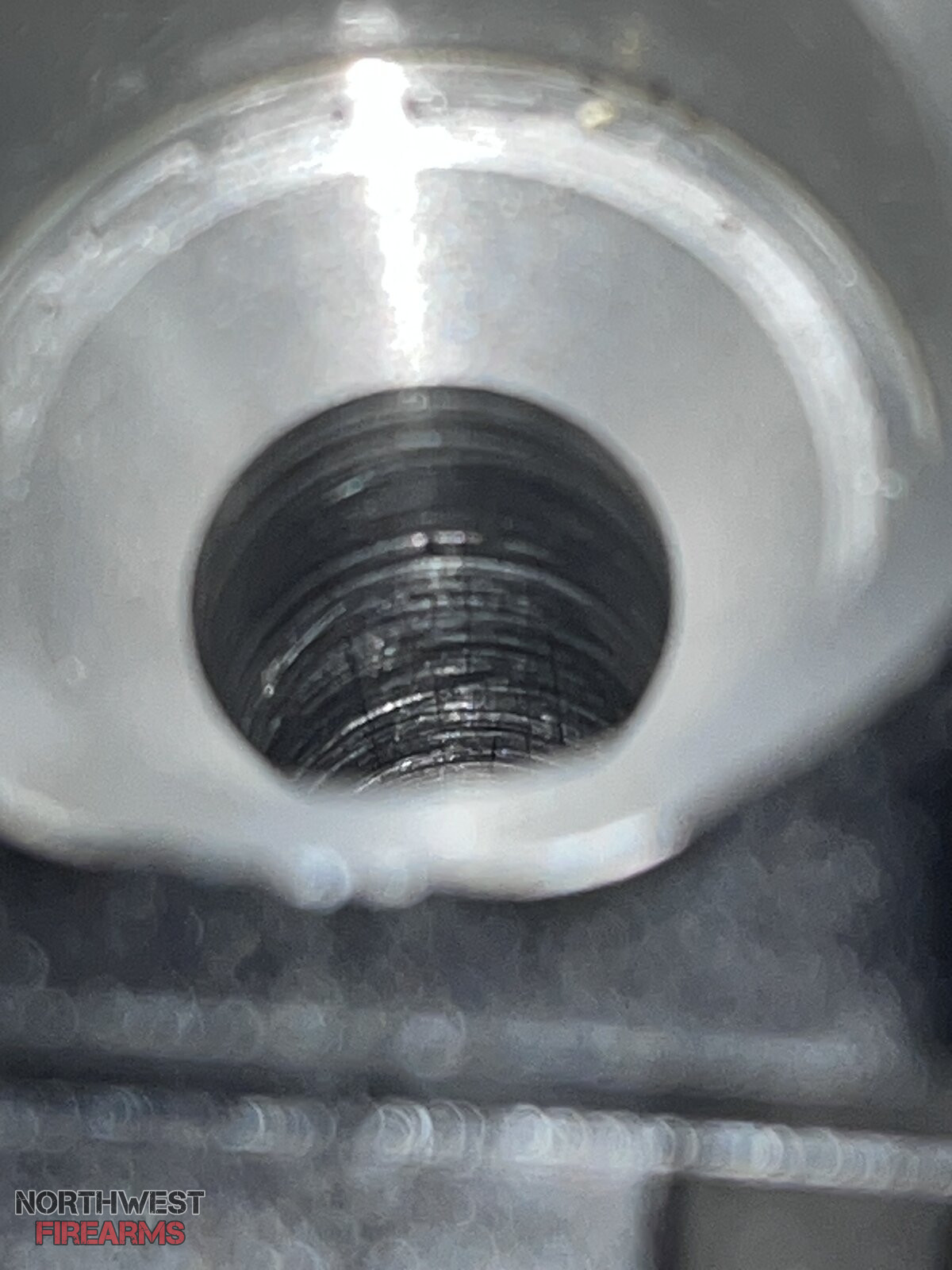

- A look into the chamber shows it's pretty rough. (See pics)
- The rounds I'm using came with it so I assume they're not for nail guns.

Wow, that chamber looks like I gave a 5 year old a hand drill and had them cut it.

That chamber is F-ugly!! It's good they are sending you a replacement, but I would certainly inspect the new one's chamber to ensure the first one was actually just someone sleeping on the job and slipped through.
Yep exactly as I suspected, that chamber is god awful and then some. Thats the culprit right there ...How that got through QC and their front doors is beyond me! Glad they rectified it for you though because thats inexcusable.
Same issues you are having. I believe blanks were made to cycle in a normal chamber while using a blank adapter on the end of the barrel.

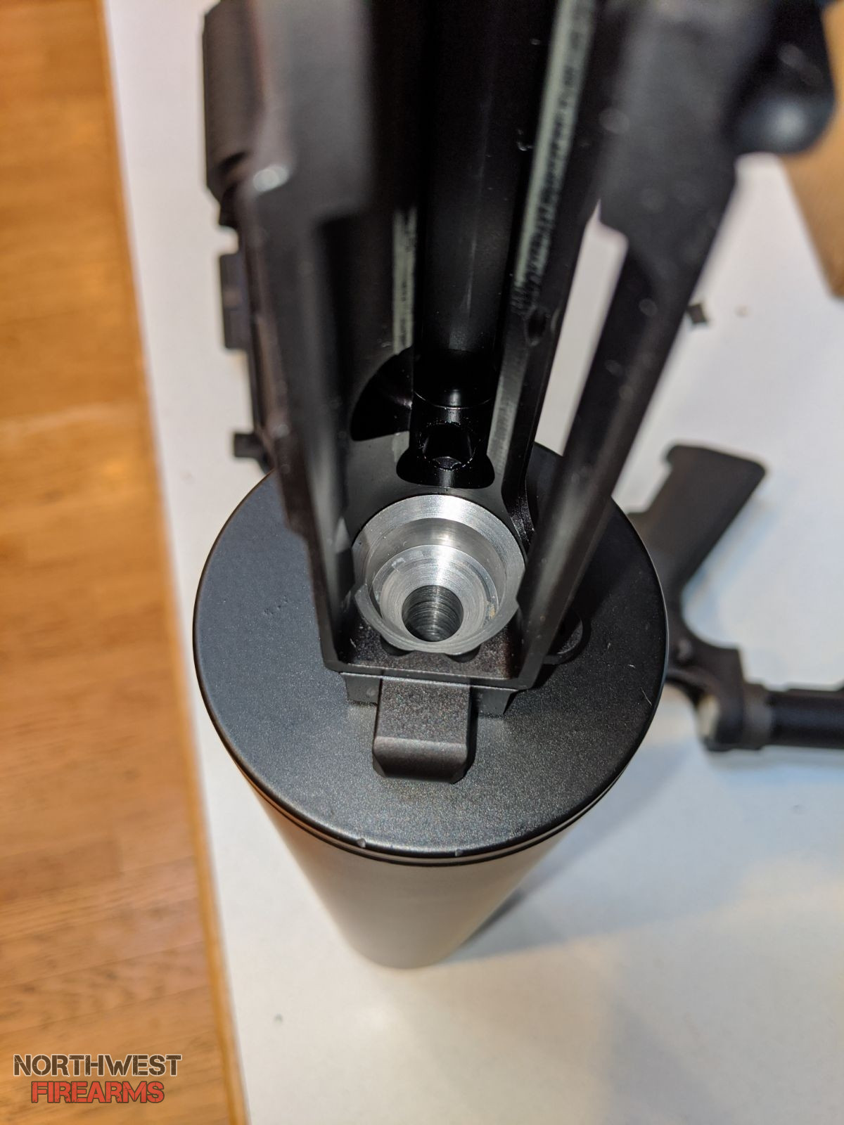

The problem as I see it, is this chamber does not have the same profile of a standard chamber. The lack of any locking lugs and proper feed ramps allow the blank to feed out of the mag feed lips at a angle that will l not chamber correctly. In my opinion that is what is denting the case. The lack of locking lugs is concerning both for feeding issues and safety.
As far as ejecting the cases, mine stick as well and had powder residue back behind the shoulder of the spent case. If a case gets stuck in a bad way there is no way to run a brass rod down the barrel to dislodge it. So far, I regret having bought it.
I got your PM earlier but had a council meeting to attend. The one I received needed some "massage" work as the chamber was very rough. We used a drill and some compound to smooth it out.
