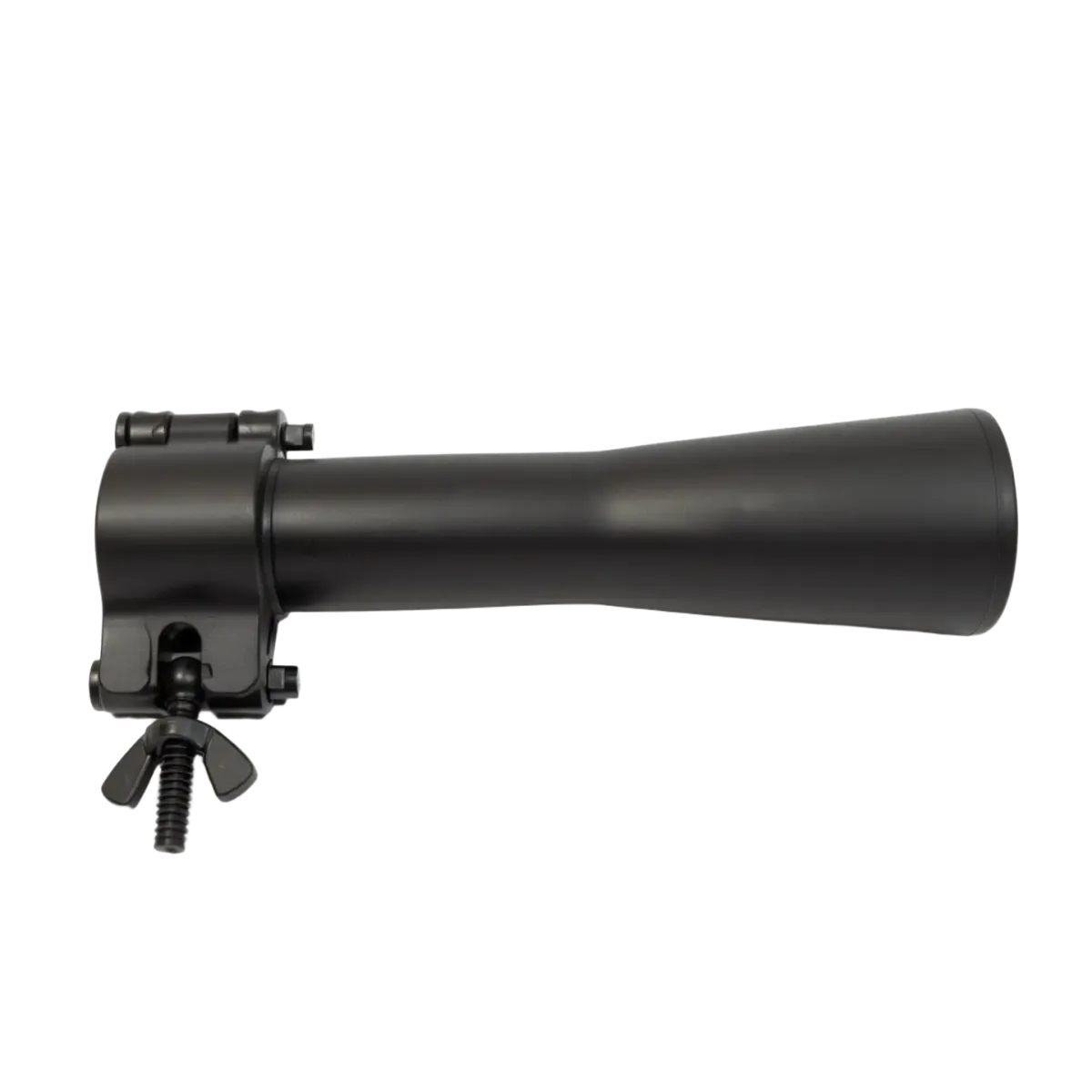

I'm interested in one of these clamp on brakes: Clamp-on Muzzle Brakes – Kahntrol Solutions
I would be interested in direct experience. I don't care if it looks ugly: function over form. I don't care if it makes me a wimp, I already must be because I have 300 WSM that caused me six months of elbow and wrist pain coming down from my shoulder that was severe enough that I could barely use a mouse let alone shoot even a .22. I was developing a load for it and may have shot it a bit much over the course of a month or two (~30-50 rds/weekend) but that's what I like doing -- without some recoil management, I will probably not use it again.
Right after WWII the military was looking to standardize their sniper rifles. One of the options was the M1D. This rifle had a clamp on flash hider that attached to the bayonet lug. By all accounts I've read the clamp on device effected accuracy to the point that they were discarded.
While technology has improved in the past 60 years I don't believe there should be anything clamped to the muzzle of a barrel.

And that M1 carbine flash hider has always cracked me up. I love seeing that WING NUT on the end of the barrel.
A few people I know who are also, like me, Swiss rifle shooters, have applied the Swiss Products clamp-on muzzle brake to their K31 rifles. These precision-made devices are so finely-made that it is very difficult to see that they are not a permanent and intrinsic part of the end of the barrel. I've fired a K31 - not mine - without it, and then with it, and the difference is remarkable. The K31, shooting GP11, feels somewhat like a .30-06, and when you see that it is shooting a 174gr bullet at 2650 fps, you can see what I mean. Adding the muzzle brake to that gun reduces recoil, according to Swiss Products of Kalispell MT, by about one-third, making prone shooting somewhat easier on the shoulder for those for whom it would otherwise be problematical.
This image is from the web page of Swiss Products, to whom I am indebted for its use.
