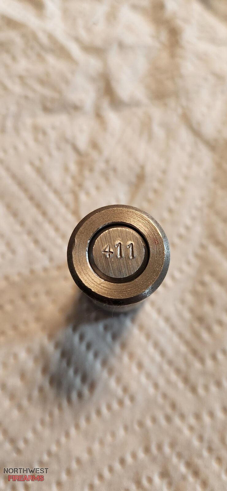

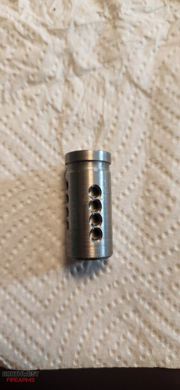

I cast for .375 Win, .41 Mag, .44 mag, 7mm TCU and .45-70 and use gas checks on all of them and size .001" over bore size except for the .41 mag as I can't find a sizing die any bigger than .410"
I had a win!
S&S Firearms make custom sizing dies that fit RCBS and Lyman Lube sizers and they happened to have a .411 die in stock. All up it cost about $55.00 including tax and shipping. I haven't tried it yet but it looks good.
