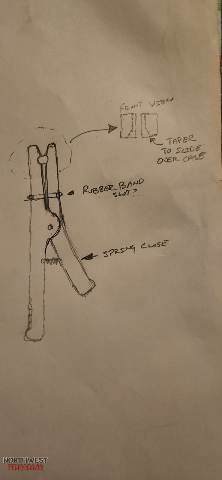

I don't want to step on Joe13's toes, but for another option, my son is into 3d printing and would be willing to try. We could test on reloading press as well. Attached is a sketch of what I think I read into what your looking for? I pictured a clothes pin, how close is it?
yeah kinda like that. light as possible loading .30 (300 BO)and soon .223 and 9mm

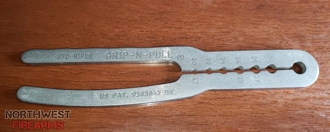

Multi-caliber plier type grips with just enough fexibility for a solid hold. Actually a nifty bullet puller, but don't know why it wouldn't work the other way round.
(See what I did there? :s0155:)
4 options/bullet size ranges available and not too spendy.

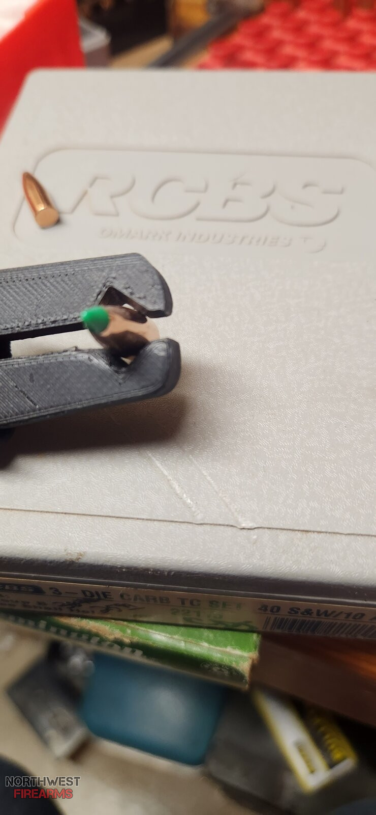

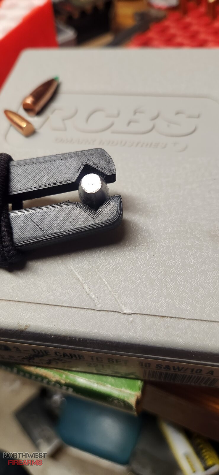

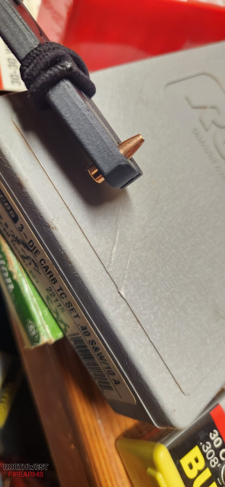

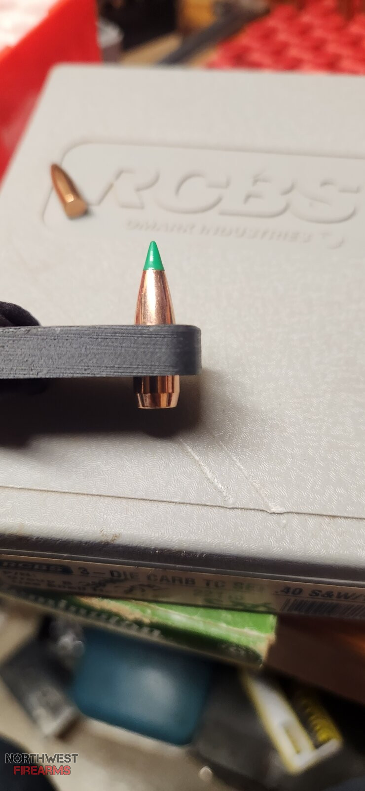

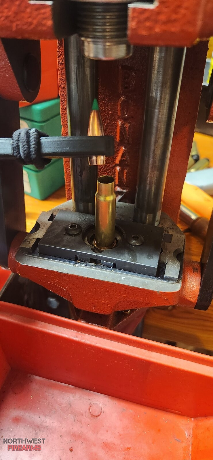

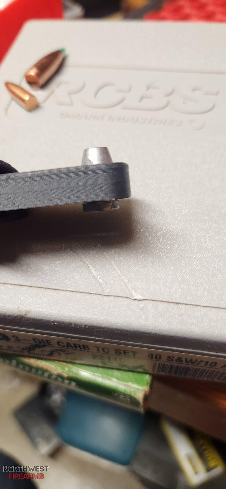

After some issues, we have a prototype printed. .......need to get down to the press and do some testing. It has a slot for a rubber band, or a spring hole on back. Getting correct tension it up first.
16658040631036844159065020008282.jpg 20221015_100902.jpg 20221015_100859.jpg
I can't upload videos, but it looks like it'll hold .22-.40 cal at least. Also, how light of 223 bullets are you using? The picture shows a 52 grain, but if your using much lighter I'd like to make sure they're not to short to hold. Please ignore the rubber band, I had to steal it from my daughter to test tension!
