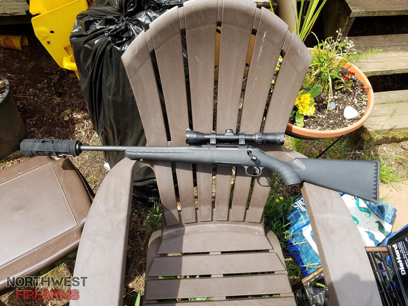

I'm going to shoot them out of my Ruger ranch bolt action for hunting, I've got an 8" barreled AR that I'm running 110 V-max out of.
