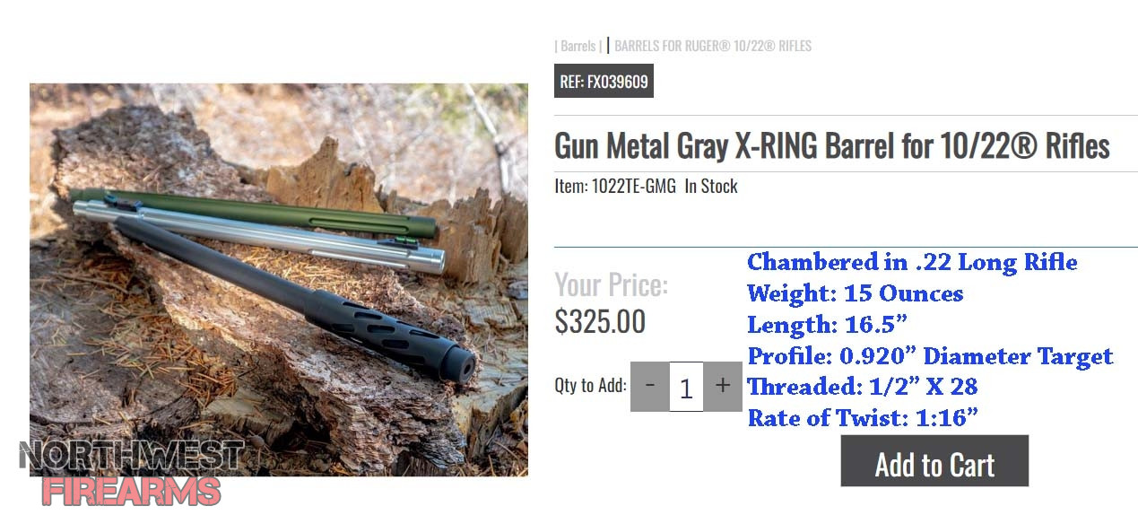

2. Looking at a bull barrel .920 16 to 18 inch (not tapered) that is lightweight. Tactical Solutions 15 ounce??? How reliable is it on street sports purpose (not completion) (not looking on bolt action rifle accuracy but close to it)

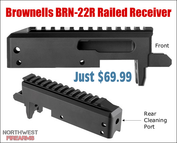

Keep the one you have and build another from the ground up. A couple reciever options have a hole in the back for cleaning breach to muzzle, which is healthier overall. Barrels offering a match chamber might be more accurate, but will be more ammo sensitive ( OAL , bullet shape , excessive bullet lube). Barrel type will affect your choices of stock ( or chassis). Stock choice will affect some optics.

Keep the one you have and build another from the ground up. A couple receiver options have a hole in the back for cleaning breach to muzzle, which is healthier overall.
***👍 What do you call this updated receiver and where can I fined one? What will be your ideal overall target weight for a tactical 16 to 18 inch rifle? Right now mine is 6.1 lbs. A bit heavier than my other 22LR rifle and could be lighter. The good news is I'm lifting weight exercise so I can comp the extra excessive weight and easier for me to handle now In other words it made me physically more stronger.***

I bought a brn non railed receiver, green mountain bull threaded barrel , use a old metal ruger trigger housing, and some other goodies. A few things I noticed was the barrel to receiver fit was super tight, very ammo picky. I works flawless with cci other brands are a hit and miss. I really feel I need to shoot a couple boxes of ammo to break it in. The BRN receivers are way better then factory ones. I am using a old factory bolt so I have no info on whats better etc. It is very accurate about half inch at 50
So is its better if I get the barrel and the receiver from the same company? Does green mountain makes lightweight bull barrels?
