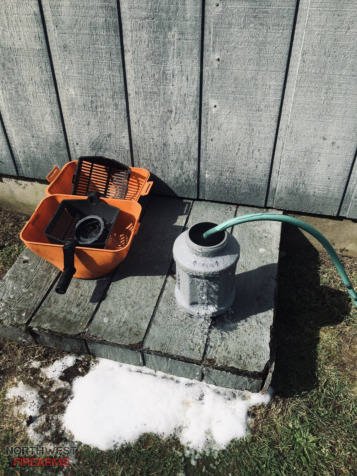

I wish the small wet fart tumbler had removable end caps instead of the single end cap. The small one would be much handier and actually work better (cleaner) for small batches. I like to put the slotted strainer in one end, remove the other and use a hose to rinse pins and dirty water through while shaking into a 5 gallon bucket. Then I can put them in my water filled Dillon media seperator to get the last few pins out.

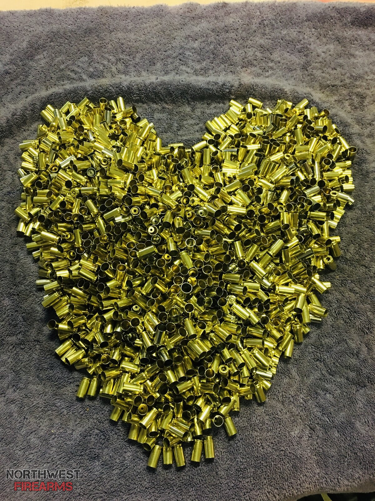

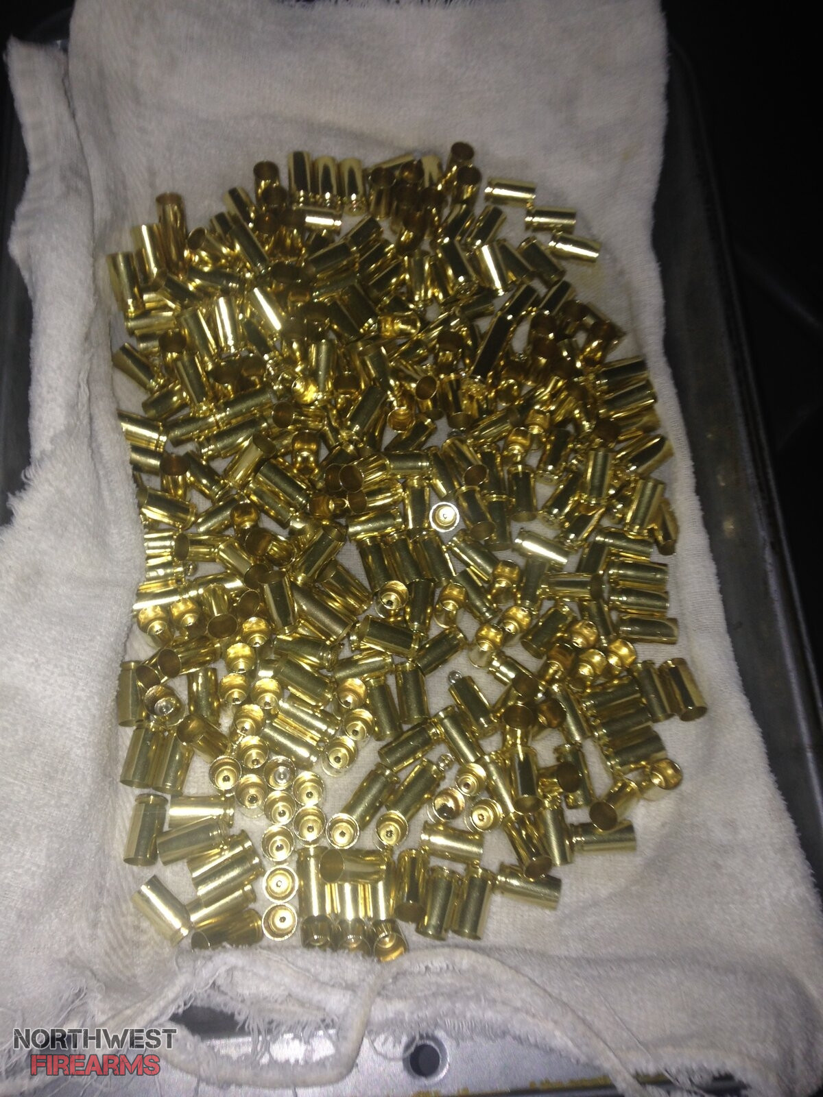

Last night I rand a batch for the full 3 hour timer which ran out about 9:00. I did not want to deal with it then so I let it sit overnight ~12 hours.
This morning I ran it for about 30 min. Still had suds, and all brass came out as good as the other couple of batches I have tired.

How does the media separator work for you? I've never had one. I just shake off the bulk of the pins and then toss a strong magnet in the drum and put it back on the machine for 5 minutes. Never had a stray pin since🤷‍♂️.
When I first started with the wet mess I liked the results with tumbling in the separator dry, there were pins left and had to re rinse due to suds.
A few times later I tried it full of water which removed ALL the suds and no pins left. :s0069:
