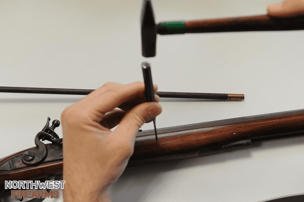

Yesterday I picked up a Pedersoli flintlock in .32 caliber and the barrel seems "difficult" to remove
for regular cleaning. It doesn't have wedges; it actually looks like the barrel was put in with finishing nails
(I'll attach photos from the manufacture).
With my old eyes regularly getting those tiny nails out and back in , in proper fashion, looks impossible
so I'll be regularly cleaning with the barrel in place using TC number 13 cleaner & Black Powder bore cleaning solvent by Track of the Wolf.

As you have just found out, pinned barrels are generally left in place for cleaning. I only pull mine once a year or so, just to check to make sure there's no rust developing in the barrel and to give it a wipe down. Or if I fall in a creek.
There are a variety of ways to clean the barrel. They make barrel flush kits that attach a tube over the touch hole or screw into the vent liner (need to make sure you get the right thread size). The end of the tube is then put in a bucket of water, some additional water added into the barrel and tight fitting jag/patch combo is pumped up and down the barrel. The idea being the water is siphoned up into the barrel from the bucket and the barrel gets clean. Personally never had much luck with this system.
Another option is plug the touch hole with a feather or toothpick, fill barrel with water/favorite cleaning concoction, let sit for awhile, dump, wipe barrel, repeat until clean.
Others will simply wipe repeatedly with a patch/jag soaked in their favorite cleaning concoction (moose milk, et al.) until the barrel is clean.
I do the plug and fill routine with hot water (heats the barrel up and promotes drying) followed by a Ballistol soaked patch.
Water is an excellent BP solvent and its cheap and plentiful. Just need to make sure the barrel gets dry and lubed afterward. Some people will add a little Dawn detergent to help with the cleaning.

One reason for pulling the pins and removing your barrel is to ensure that that there is a coat of finish on the wood of the barrel channel and also to apply a coat of paste wax, or perhaps bees wax, to the underside of the barrel to help prevent any hidden rust from developing. These are not mandatory steps but I believe that they are a good idea. I pull my pinned barrels every 5 years or so and renew the wax. No rust, so far.
I recommend that you remove the pins from left to right and replace them right to left. This is opposite to what your picture suggests and it is a pretty much a standard practice.
Some pins have a slight taper to them with the tapered end being inserted first. I think it is worth putting a slight taper on the pins, if they don't already have one, and I do it to all the pins in my pinned barrels.
