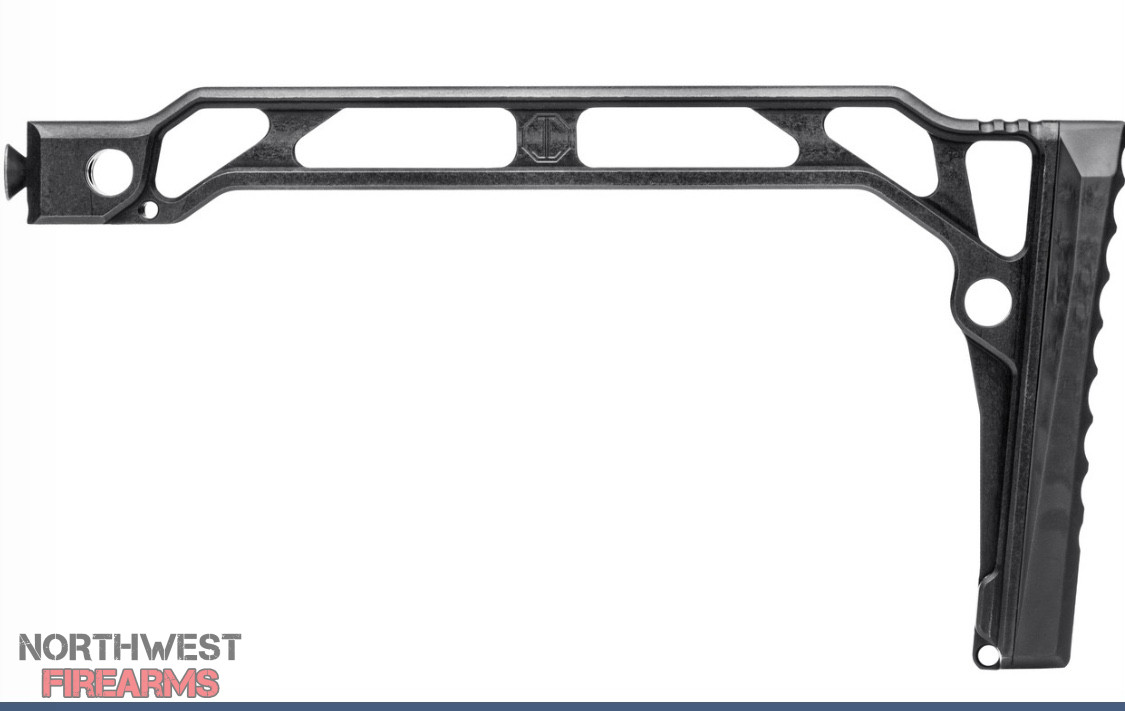

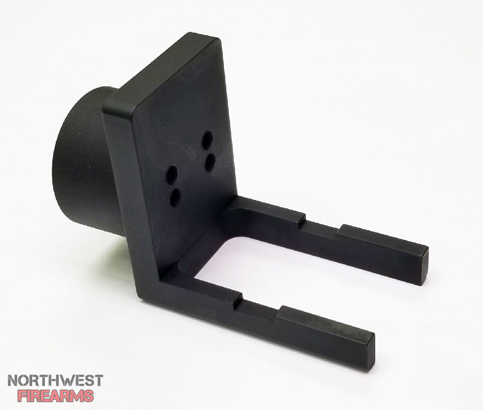

So, I am looking for AR-15 carbine stock that is sort of like this:
It will attach to a carbine type tube:

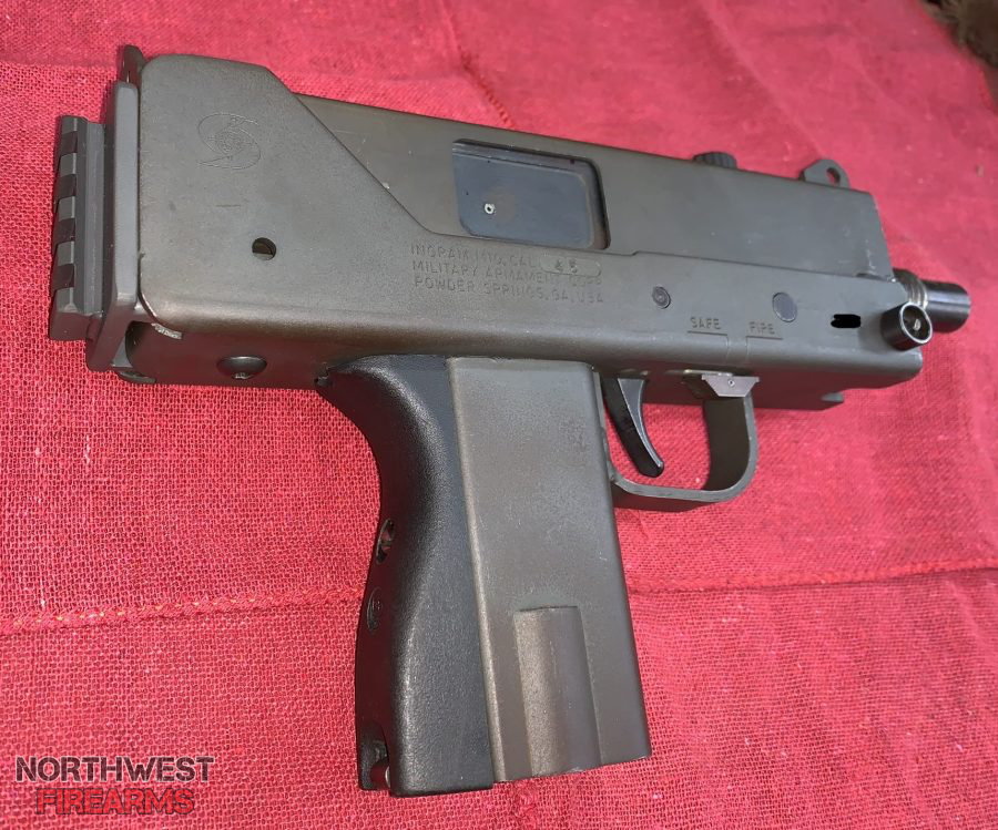

It does not need a spring or buffer as it is attaching to a submachine-gun that has an AR-15 adapter.
Suggestions? Thanks! :)

I would adapt it to picatinny/1913 rail. The sky is the limit for the type of stock you can use probably 100+ options.
These kind you can put wood inserts or cheek risers in which looks really cool Imo.

I have the Doublestar skeletoon stock on one of my own builds in 458 Socom. I wrapped the bars with paracord, which gave it a nice look, a little better grip and the utility of having a nice chunk of cord right there on the rifle.

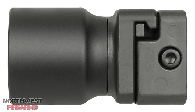

My understanding is the adapter I have only works with carbine type tubes
The reason they specify the carbine tube is because of the way the AR buffer tubes are retained on an AR. For the rifle the threads are just long enough to screw in and capture the buffer retaining pin and there is a flange to keep it from going in too far. the stock is then screwed to the back of the tube and there is a nub on the front bottom of the stock to prevent everything from rotating, so you get basically a 3 point lock up. You can see the nub on the front of the ACE stock as well.
The carbine tubs can't be attached to the rear of the tube so the threads are longer and you use a castle nut to lock the tube to the receiver, and you would use that same way of locking up to attach it to the adaptor.
So you can use a rifle stock with any of the adaptors, the thread depth into the receiver is the same on both the the rifle and carbine, but the rifle tube wouldn't have the castle nut to lock it down. You could use Rockset to keep it in place or a screw run through the bottom of adaptor and tube would work. If the back of the adaptor is open you could even get a nut in there on the screw
Photo for reference
