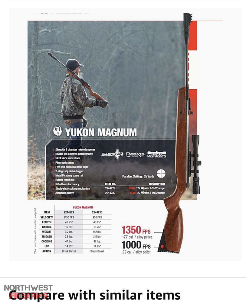

Is that 1000-1200 FPS? If so I would be using the heaviest pellet I could possibly get (make sure it's dome shaped). I would expect something that velocity to literally be all over the place. Please excuse if fps is not what u meant.
Yes FPS,
Bought it with the branding of like 1270....1250...12something big on box. Reading the finer print it *with alloy pellets **** but a lower FPS for a standard pellet used in same rifle. I was okay with that. 1000 is what I'm usually looking for. Someone here said that's marketing non-sense which I can agree with.
This is from Amazon but it's close enough to what I got at big5 last summer. Hehehehe I paid a much better price.... bought scope separately
Its marketing... mostly. I mean, I wanted a powerful air rifle and velocity has to do with that. But so far I cant even find alloy pellets light enough to hit that velocity. My rifle is marketed "up to" 1100fps, but so far the pellets I can readily buy chrono between 757 and 800fps between 14.3g and 12.81g.
