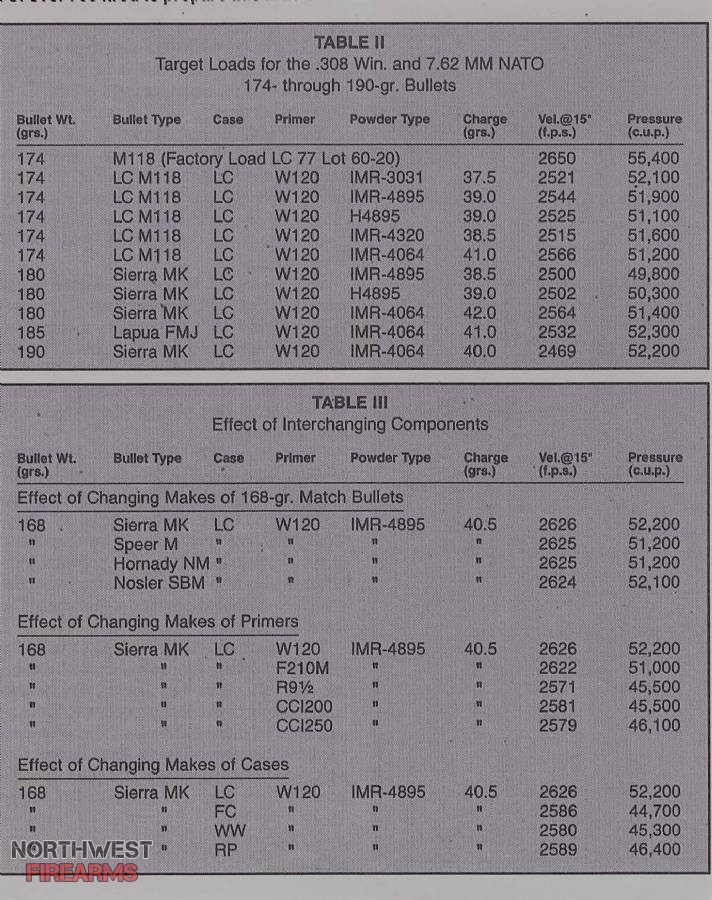

Although not exactly related to your test parameters, table III in this image shows the effect of various primers in a specific .308/7.62 load, shot out of a .308 SAAMI test barrel. Breech pressure was directly measured, and not calculated. Posting only as an example of the differences in large rifle primers.
