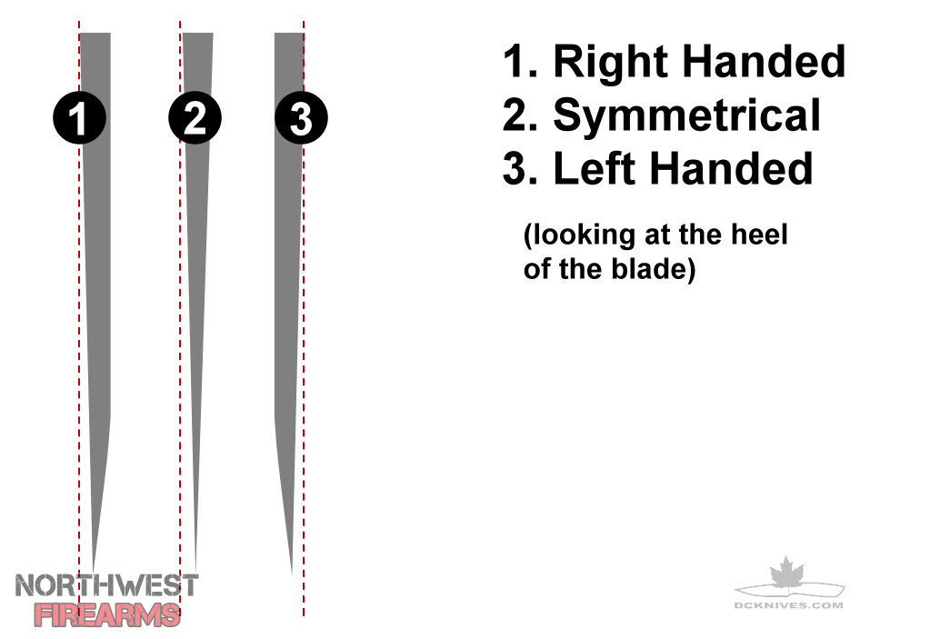

Another thing to pay attention to, and most of us Americans don't know this, but some of those amazing Japanese Knife blades can come left or right handed in addition to symmetrical. The blade grind is different, and if you aren't paying attention and sharpen it like a regular knife blade, you'll mess up the blades intention. See diagram below.
