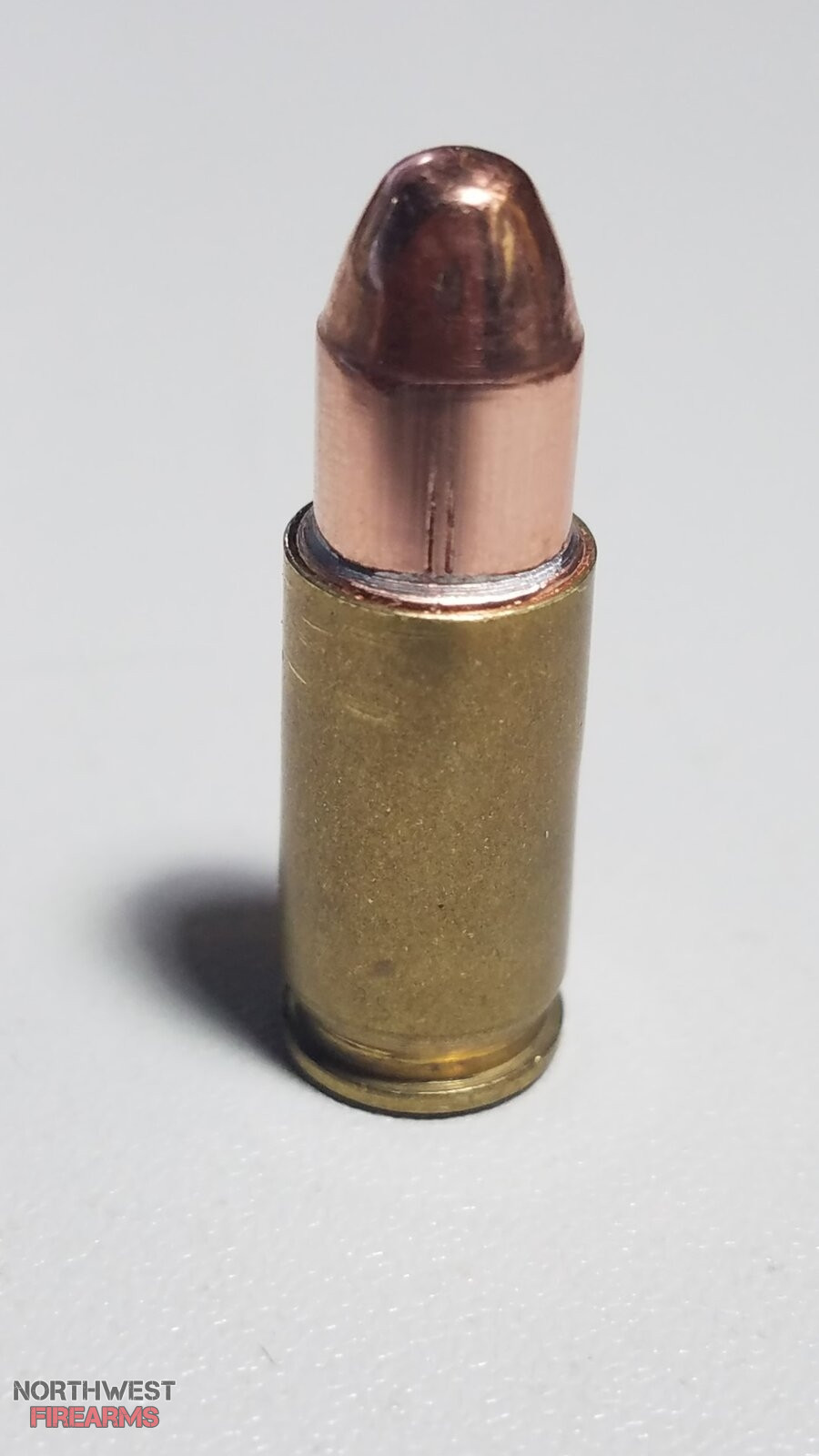

Today I have been pulling apart some 9mm. Using a collet type puller.
This one was really stubborn, and I still haven't got it out yet.
But when I do get it out, I can still reload with it, right?

What is the 'gap' between the bullet and the case? - and what is the 'silver' colored thing/coating between the bullet and case?
I have never seen anything like this ever when pulling bullets from cases.
Also, that case looks oddly 'thick' at the mouth with no sign of a crimp.
Plated bullets don't pull too well with a collet puller, do they?
I've seen similar, because I've done it before. The collet squeezes the soft lead down and breaks through the thin copper plating. I'm pretty sure the OP was joking about reusing it. That's one for the scrap bucket. :)

Um, wow. How did you do that? are you gonna show a photo of it once you get it all the way out? I have so many questions. . .
My puller has run out of clamping power. I can't get another bite out of it.
These were Xtreme 9mm plated 165's I loaded too hot.
When seating a 9mm 165 grain, the neck tension becomes quite high because the depth of the shank in the case.
On the left, a pulled 165 grain. On the right standard 115 grain.

It appears that you smished it Cheeky Monkey. Lop it off and load it in your .32. :s0114:
