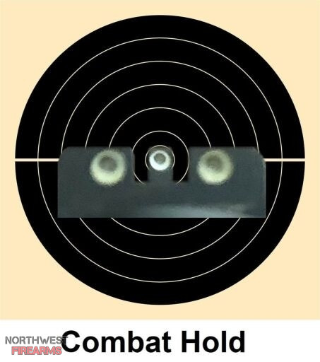

  • Combat Hold (or Frame Hold) – The center of the front sight post completely covers the bullseye. If the sight is equipped with a dot, the center of the dot will cover the center of the bullseye.

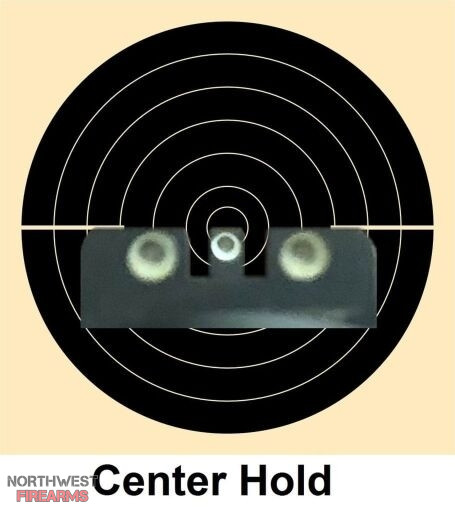

  • Center Hold – The top of the front sight post perfectly bisects the bullseye horizontally.

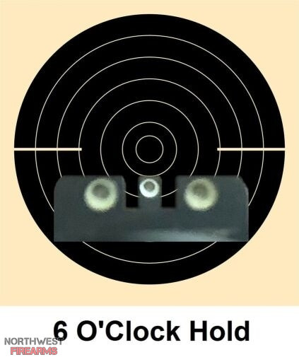

  • Six o'clock hold – The top of the front sight post sits directly underneath the bottom of the bullseye. For obvious reasons, this hold can also be referred to as a "lollipop hold" or "pumpkin on a stick".

So far I've seen no mention of the effect sight picture can have on point of impact. Your firearm is set up by the factory for combat hold or a target hold. Simply put, if you're using a different sight picture than the factory set up, then your point of impact will not be where you expect it to be.
I'll extract some portions from this site to explain the difference (the whole article is worth reading if you have the time & inclination).

Confusing with those images and all the different names for the holds.
Feel free to use the image and the descriptors in Post #55
