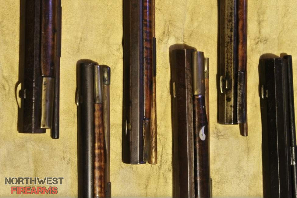

Thought I'd post a few pictures of my recently finished longrifle.
It's a chambers kit in. 54 cal. 38" barrel, mostly curly maple stock.
What a project! I've built a number of firearms, but this one has been the most satisfying, my 1911 being a close runner up.
Now I'm just trying to work up a good load for it!
I really enjoyed building it and I'm proud to share it with all you fine people!
20190510_150625.jpg I know the front site is backwards in this pic, I've since fixed it. 20190510_150606.jpg I built the horn too. 20190510_150212.jpg 20190510_150206.jpg IMG952750.jpg IMG952753.jpg IMG952757.jpg IMG952765.jpg even the wife likes it. IMG952735.jpg
