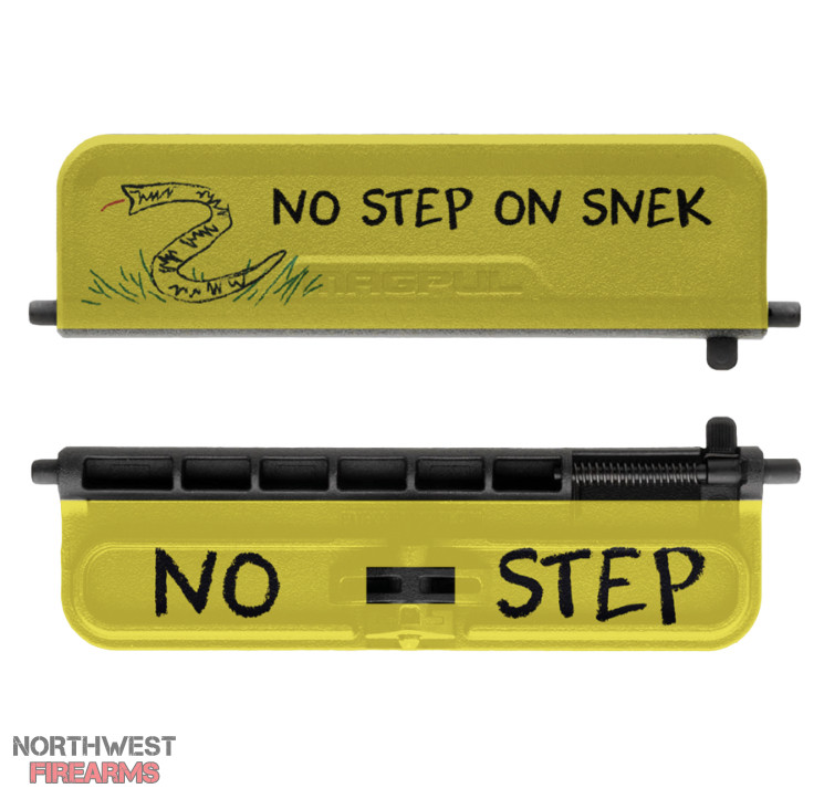

Hell of a premium for this, but I might need this.
