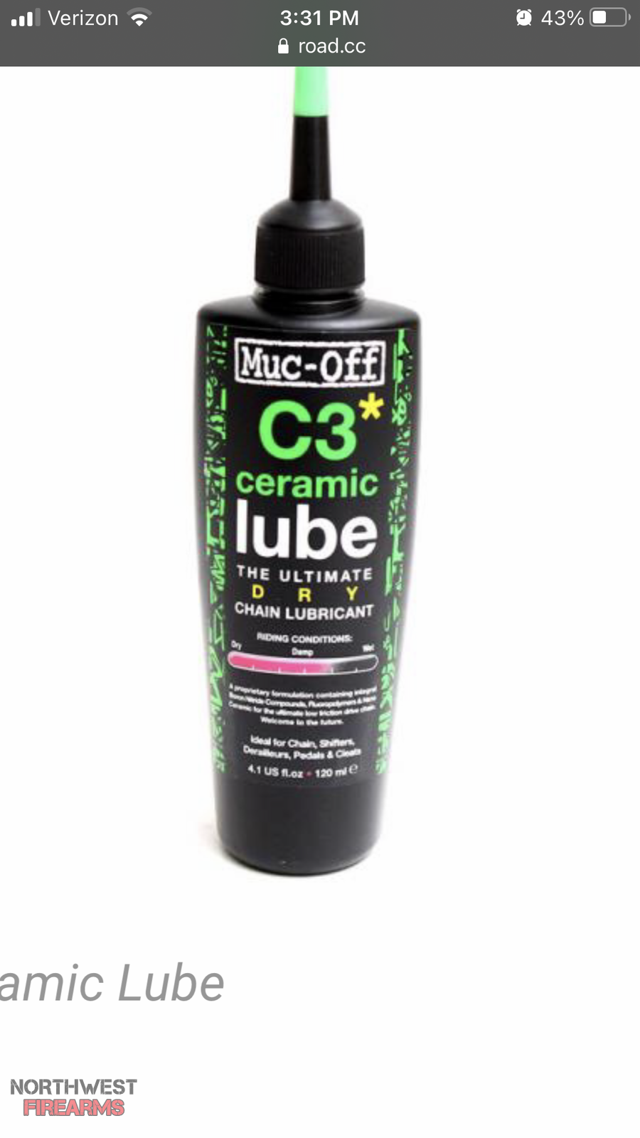

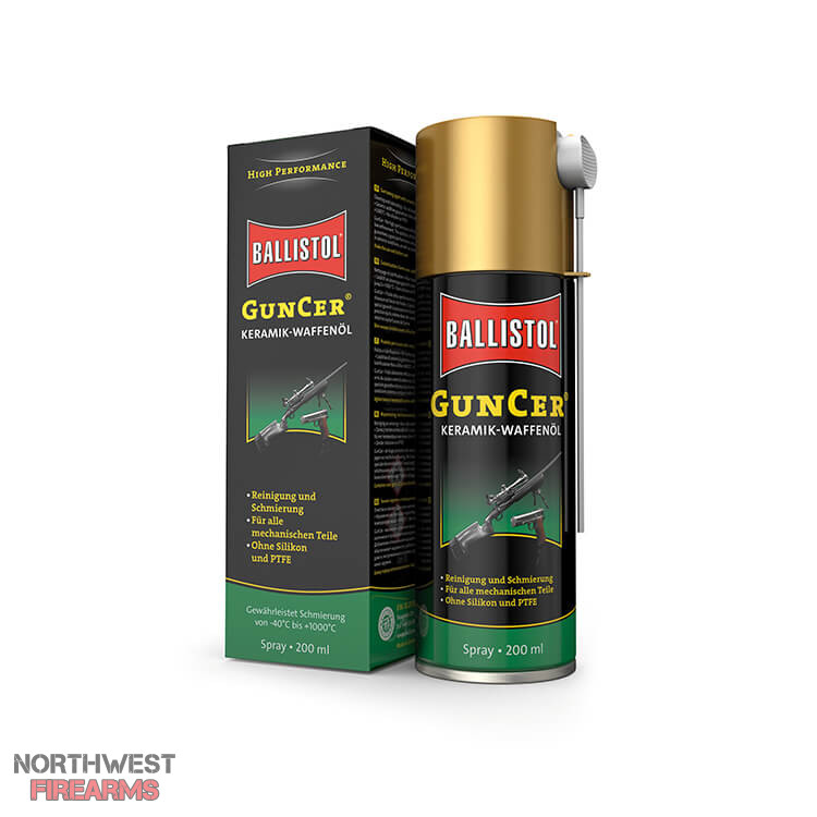

Seems like this is really catching on in Europe. I noticed several brands using boron-nitride micro particles in their formulations. Even Ballistol has a ceramic enhanced version now in Europe.
This hasn't caught on yet in the states but it's just a matter of time imo. Bicycle lubes such as finish line are going from a Teflon formulation to a ceramic plus Teflon formulation. Also muc-off c3 seems to be leading the way in the bicycle chain lube/general lube world.

I think this is going to be the next wave of gun lube and in 5 years (or sooner) all the best gun lubes will contain boron-nitride "nano particles" or whatever you want to call it. The properties are outstanding and protect up to 1150 degree F as I recall (edit: I noticed the ballistol can says 1000C, or 1832 degrees F).
Here is a pic of the ballistol one and muc-off. I can dig up the names/sites of the others I found in my rabbit hole research if anyone is interested. Edit: As I recall there were 1-2 small us makers too but not sure. Those were very small not common name brand companies.
