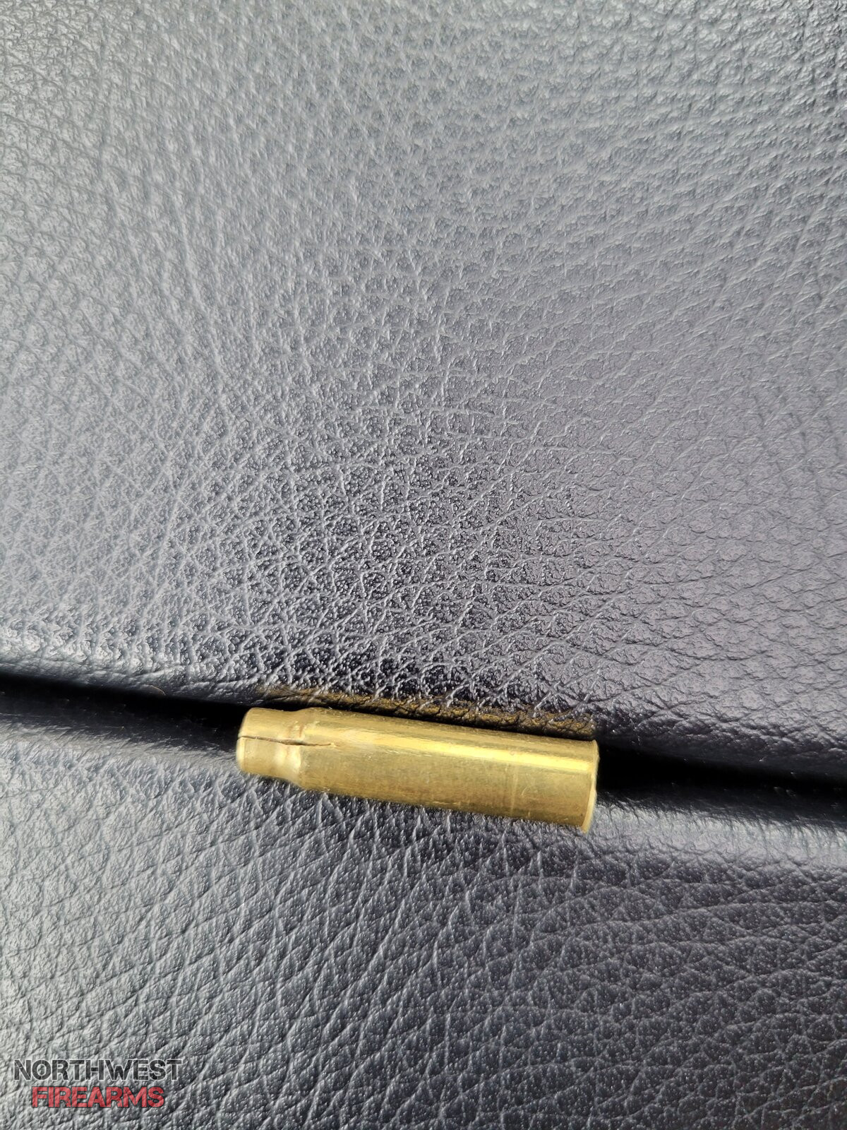

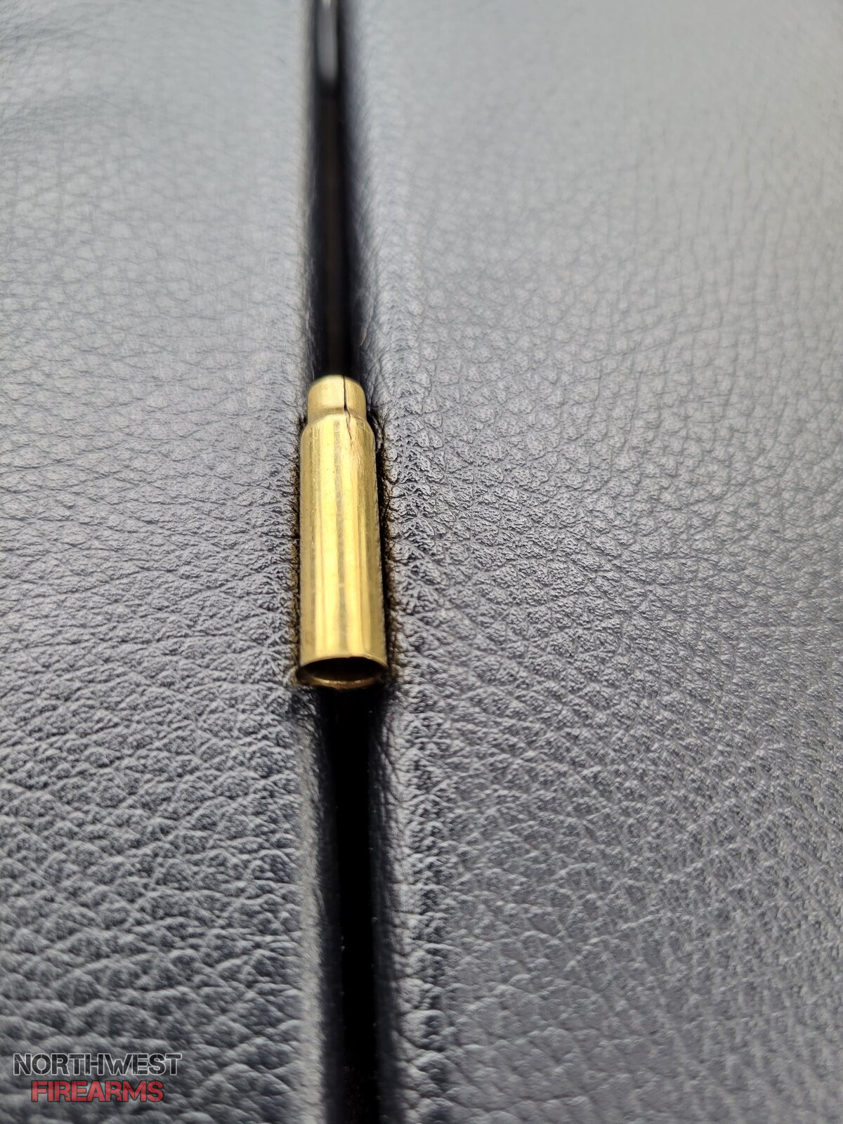

Went and shot my Ruger Precision 17 a couple weeks ago just to make sure it was still dialed in and to group some different ammo. All rounds loaded from the attached mag. First 2 shots landed right where I aimed. Went to load my third round and somehow jamed up the round so I just ejected the round and tossed it in the dirt and proceeded to load a round from the mag and everything seemed smooth and normal. Pull the trigger and boom. Sprayed me pretty good on the hand, face and the person sitting on the bench next to me. Pretty good cut to my thumb that proceeded to bleed pretty good.
After the initial WTF and a bandaid on the thumb I start inspection. Rifle was jammed part way closed and cartridge stuck in the chamber. After a couple soft taps with a mallet on the bolt handle the bolt opened and out pops the rim of the cartridge that was torn off. With no rod small enough to try to get the stuck cartridge out that rifle is done for the day.
Now at home with my bore light I can see the bullet is still in the barrel about 1/2 way down. I get the bullet out but can't get the cartridge out. Off to the gunsmith. He looked over everything and extracted the cartridge. He headspaced it and gun was gtg. In his opinion the round was was over pressure. What do you say? 20220425_154649.jpg 20220425_154633.jpg

Federal 17 grain with the black poly tip. If I had to guess I purchased it last year or Christmas time 2020. The first two shells looked fine as did the rest of the sleeve on visual inspection.
I agree with the gunsmith. It was a bit too hot. If it wasn't a bolt gun I'd question being out of battery. Otherwise the neck split leads me to blame it on an overcharge.

I would contact Federal with the remaining ammo you have from that lot and see if they are aware of any issues and what they are willing to do on it. Maybe a bad lot that was overcharged, or bad brass? I personally wouldn't fire anymore of that ammo until I talked with Federal.
With ammo supply/demand being what it has been the last 2 years, and prices reflecting the situation, I'm sure ammo manufacturers are pushing the limits to get product out, which could lead to unfortunate situations such as you experienced.
Glad the damage to you and firearm was not worse! I've probably witnessed 12 case head separations in 17HMR rifles....mostly bolt guns but also in 4 different semi autos. And also several squib loads that resulted in ruined rifles after firing another round into a stuck bullet. Its not limited to one brand of ammo either.
I don't question your gunsmith, but the fact that the bullet did not exit suggests to me that the load was not over pressured... prob not enough propellant and the stuck bullet creates enough back pressure to separate the head.
I believe the real problem is the poor quality of most 17HMR ammo that operates at very high pressure for a rimfire. JMHO.

When you tried to chamber the third round and ended up ejecting it , if the neck was cracked it may have left the bullet or the plastic tip in the barrel.
I had the same problem once. the next round would not chamber correctly so I ejected it. The next round was hard to chamber, and when I pulled the bolt back the nose was deformed. There was a bullet stuck just into the rifleing. I found the ejected case and the neck was cracked. With no neck tension , when I pulled the bolt back it left the bullet stuck in the chamber. DR
Best theory yet (and backed up by previous experience).
I don't understand how a bolt gun that has been fully closed before firing could end up in that position. There were out of battery discharges in early 17 autos that split the necks like that. I'm wondering if the bolt was not fully closed and it fired out of battery.
