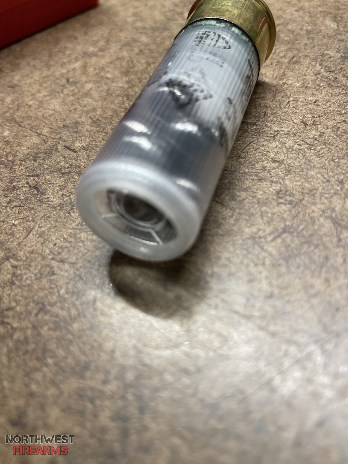

After trying different stuff…. I had to look for 00buck and in roll. But I like it. Seems quality. Sterling … found at PSAs daily deals while back. Now just need to find a deal on #4
